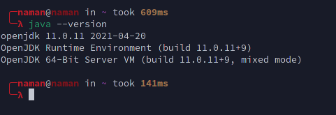

How did you install java? Looks like it is working fine for me
Screenshot from 2021-05-30 21-01-01
 ╰─λ java --version
openjdk 11.0.11 2021-04-20
OpenJDK Runtime Environment (build 11.0.11+9)
OpenJDK 64-Bit Server VM (build 11.0.11+9, mixed mode)
I installed with
sudo pacman -S jdk11-openjdk
Also post
sudo pacman -Ss jdk
