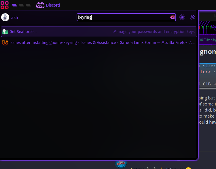

Let me
it for you
https://duckduckgo.com/?q=an+application+wants+access+to+the+keyring+default+keyring+but+it+is+locked&t=newext&atb=v251-1&ia=web
All the first hits seem to suggest getting to the function to change the keyring password (tbd how, e.g. just search keyring in the application launcher), enter the old password and leave blank the new one.
Just like the KDE Wallet tip.
Search also for "Passwords" and have a look also here:
https://wiki.archlinux.org/title/GNOME/Keyring#Manage_using_GUI
