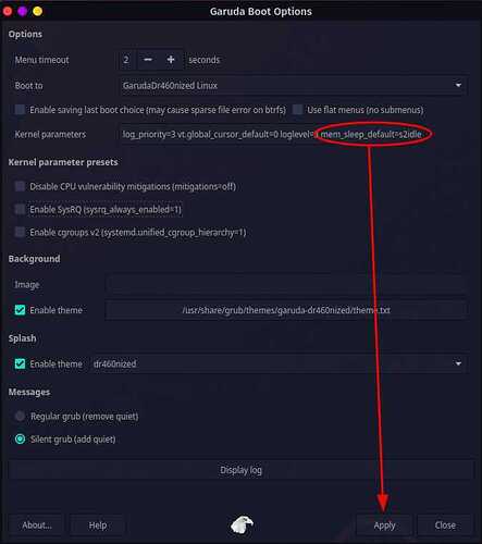

Test if changing to the s2idle suspend mode allows a normal resume from suspend. You can do it right from the Garuda Boot Options app.
Find the line that says "Kernel parameters" and the value mem_sleep_default=s2idle. Add it at the end of the line, after whatever is already on there. Then click Apply at the bottom.
After that, I would go back to your screensaver settings and re-enable the lock screen since you noted you will need to use that.
Reboot, then in the fresh reboot test if you get a different result waking from a suspend state.
