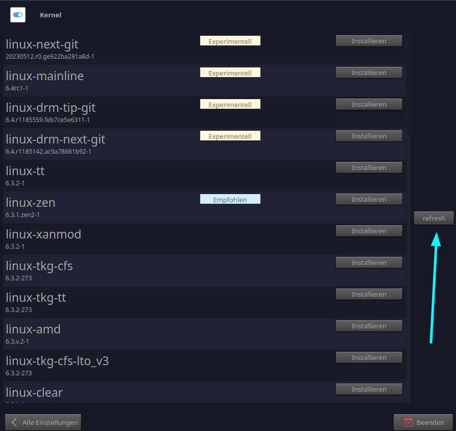

Works fine here, did you “refresh”?
yes, several times but with no way
I have change mirrorlist to other country without solving
