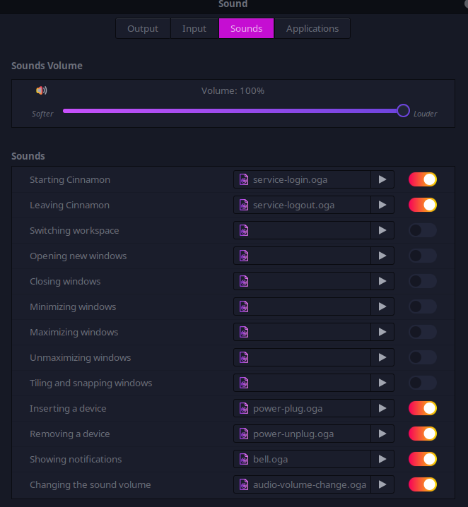

I use a stereo system that I have connected to PC. I have QSC amplifier connected to a mixer that is connected to my PC via blutooth. I have no problem playing sounds. The only things that don’t seem to be working are the “clicking” sounds that Linux makes when you increase or decrease the volume and the sounds from notifications.
Edit: I think I have found the issue, all of the “sounds” are turned off and there seems to be no audio files for the sounds.
Screenshot: https://files.catbox.moe/hedpnw.png
toggle the last one to on chancing the sound volume?
for sound on notifications maybe you find them in the system sound settings for the browser? i dont know im not on cinnamon.
Screenshot_12-Apr_02-50-08_25668
Screenshot_12-Apr_02-50-22_22652
ps. @elite posted some pic in the chat for you
Yes, I managed to find a sound package called “Free Desktop” which had some of these sounds. I got the ones I cared about at least, thank you for all your and Jeshu’s help.
Screenshot: https://files.catbox.moe/r9scll.png
