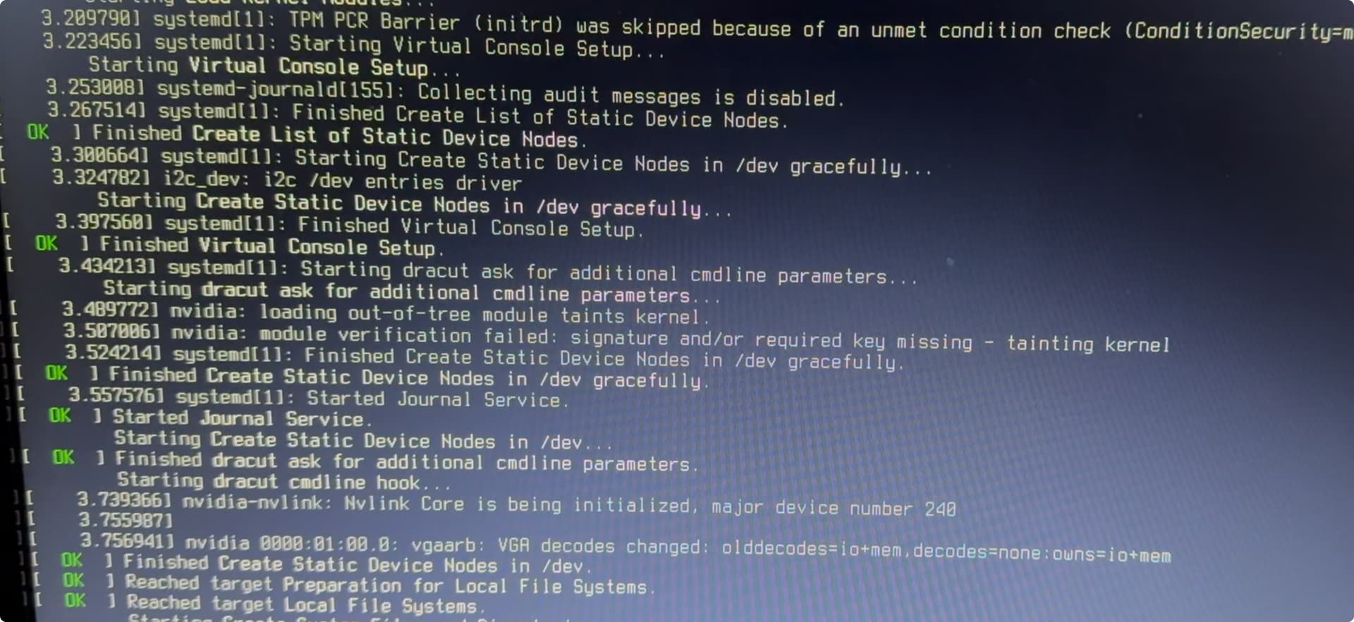

The above guidance has been super helpful along with scouring the forums. That being said I am getting a black screen with nvidia card plugged in. Adding screen shots.
I get to grub and than it loads the kernel message and start the screen goes by pretty quickly I see the taint comment
it loads the driver
than I get blank
after blank I an unable to hit tty or anything else, neither can I get tty from grub or while the system is loading.
Any clues will be super appreciated.

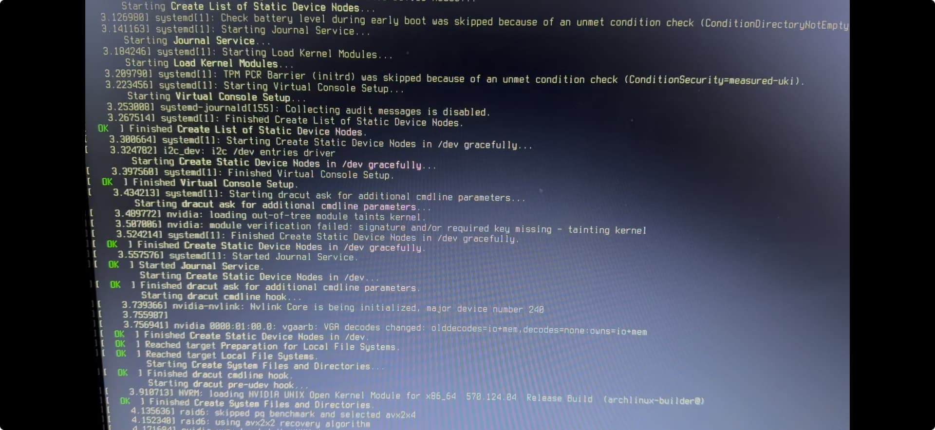

I have disabled noveau driver followed by radon driver that comes onboard.
I got a bit further by going to recovery mode to see the journal. I see this error
[drm:nv_drm_load [nvidia_drm]] ERROR [nvidia-drm] [GPU ID 0x00000100] Failed to allocate NvKmsKapiDevice
next line is
nv_drm_register_drm_device failed to register device
