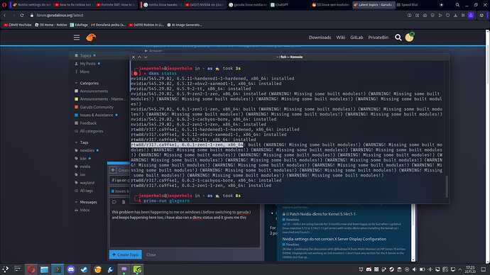

If i go on greenwithenvy (nvidia settings ) it tells me that it didnt find NV-CONTROL-X
this problem has been happening to me on windows ( before switching to garuda ) and keeps happening here too, i have also ran a dkms status and it gives me this
but im able to run prime-run glxgears

Which ones have you tried?
isn’t it when i do dkms status it tells me everything?
