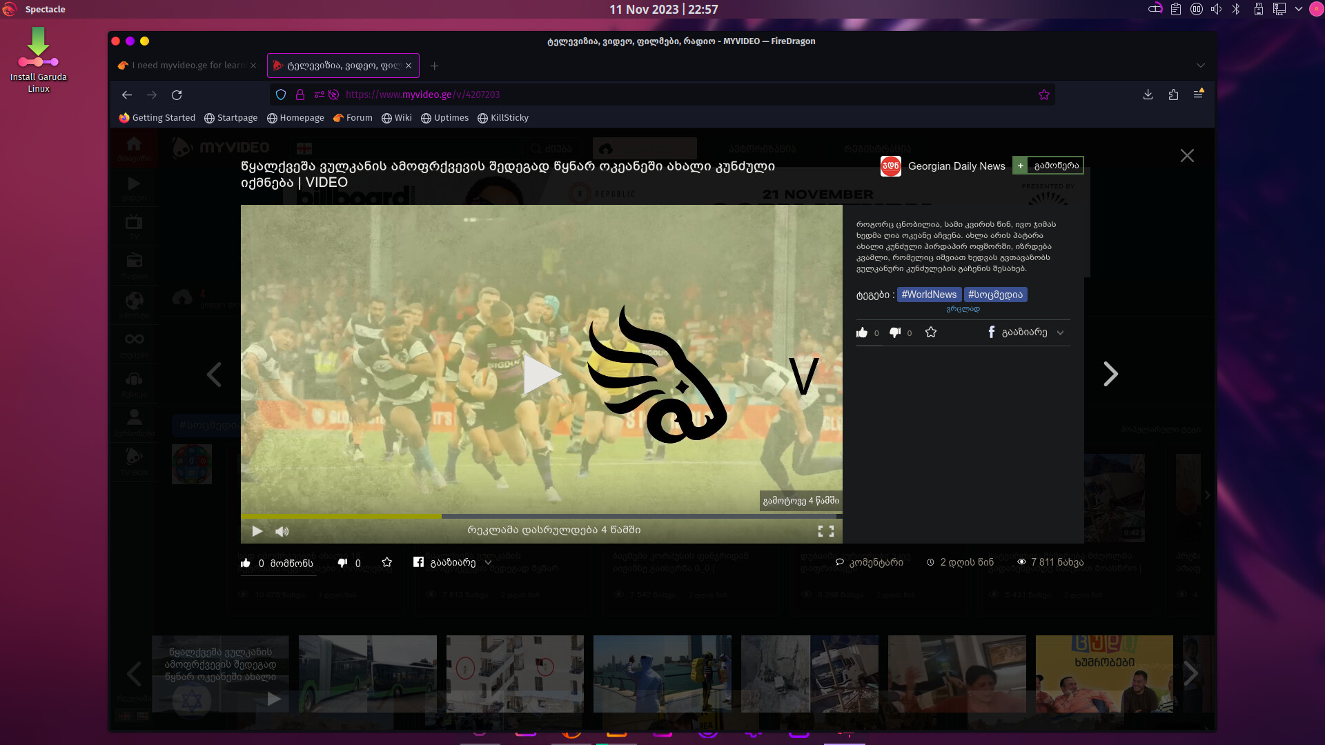

Well, this is what I get from that exact link. Make sure you have DRM enabled plus maybe an MP4 or FFmpeg extension(s) installed.
I sourced these running FireDragon from the latest dr4gonized Live ISO.
