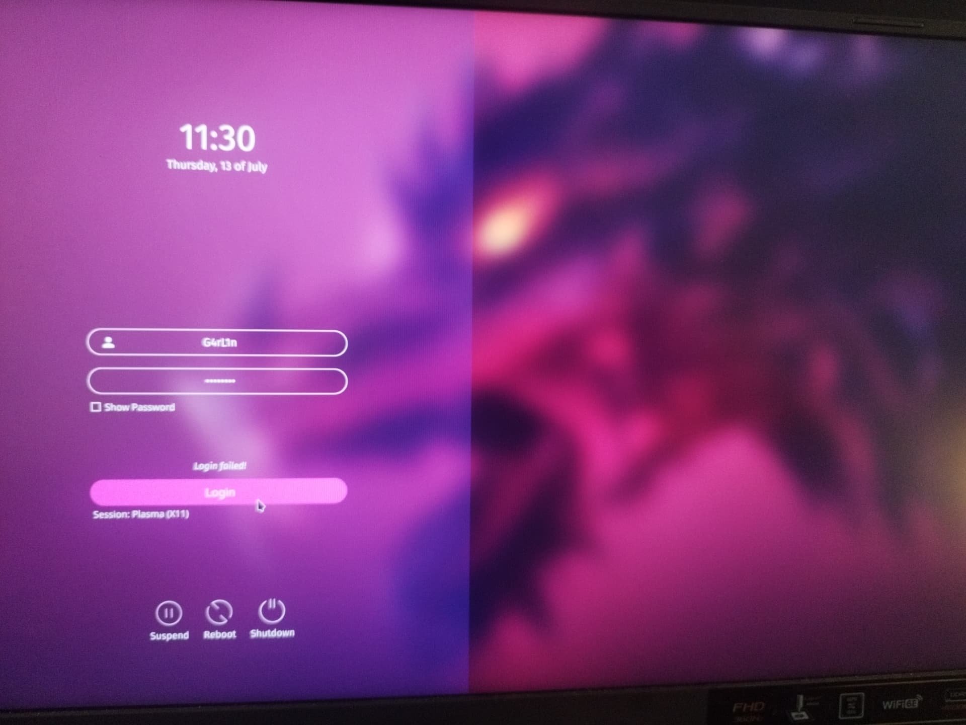

I've updated my garuda and cant login.
Its second time ive updated my garuda and cant login. Last time i restored it to before the update.
Login screen changed also

Try switching to a TTY from the login screen to troubleshoot. You can press Ctrl+Atl+F2 (or F3, F4, F5, and so on) to switch to a TTY, then try logging in from there to see if it succeeds.
If the login fails from the TTY also, try typing your password in the username field where you can see the characters that are being typed. That way you can confirm the password is being typed as you expect--Shift is working, the symbols on the output match your keyboard, etc.
Tried Ctrl+Alt+F2 and cant login and im sure i type correctly my password

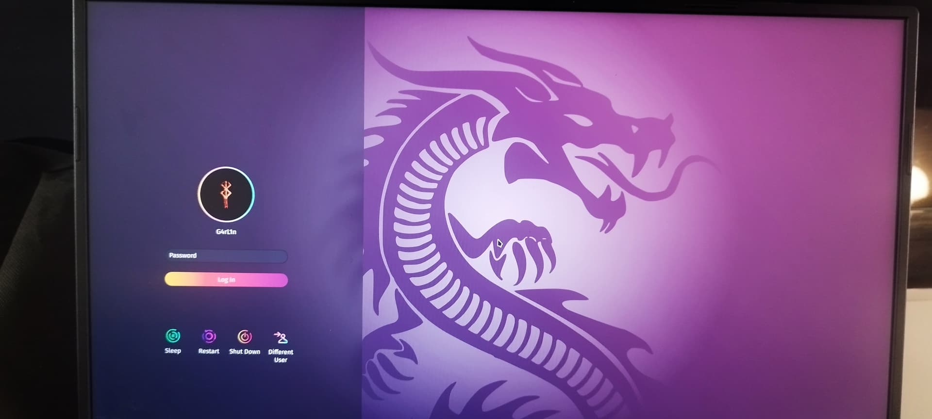

Can you explain more specifically how the login screen changed?
From this to the screen shot that i post first
