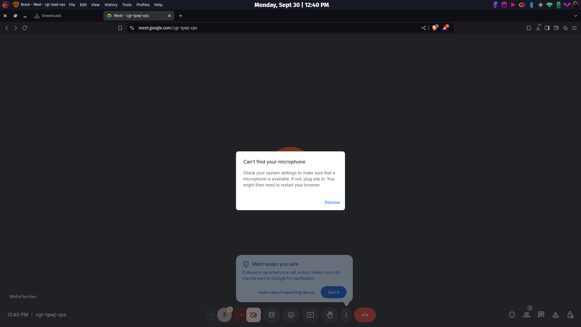

I can't able access my microphone both in brower and system

Instead of a picture of the entire desktop because of a short message, you should better tell what exactly you tried and how you searched the net for a solution.
I’m running that same chip in my laptop, different board though. Kernel support for this chip on my board came with 6.10 AFAIK. It’s a stereo digital microphone. If you get this
sudo dmesg | grep DMIC
[sudo] password for veitw:
[    7.354178] acp_yc_mach acp_yc_mach.0: Enabling ACP DMIC support via DMI
then you know it has been at least recognized and configured by the kernel. That’s all i know about it.
