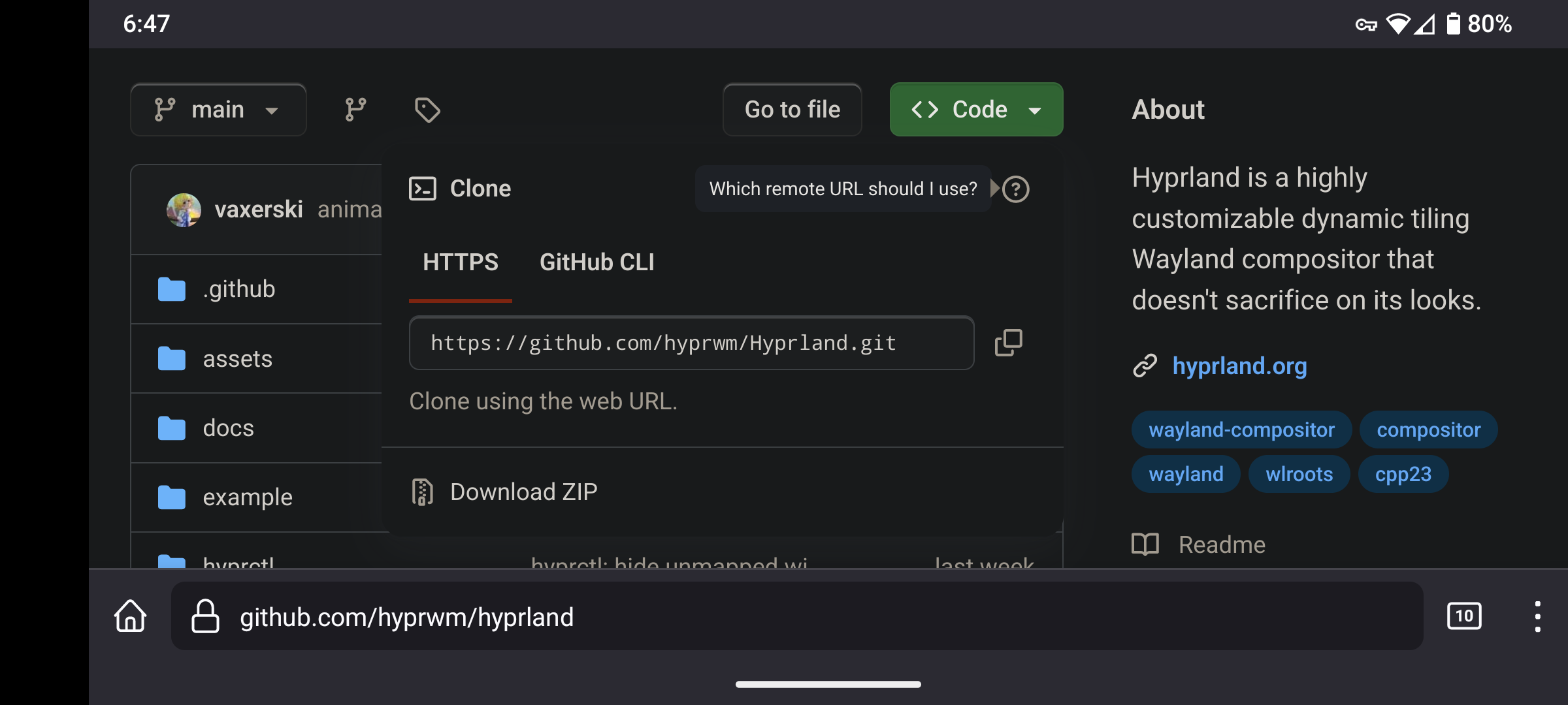

If you are trying to clone the repo, you are missing the .git at the end of the URL. See the drop down if you click on Code:
❯ git clone https://github.com/hyprwm/Hyprland.git
Cloning into 'Hyprland'...
