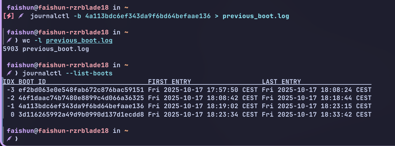

So my previous boot is with IDX -1 (X11 logon failure). Here’s the full log of journalctl -b 4a113…SNIP…ae136: https://bin.garudalinux.org/?511981273d81cc1f#33y8pnXDqYYsHGruUeWnCPJyUcKqDZqMj1v4TAEPi4yi

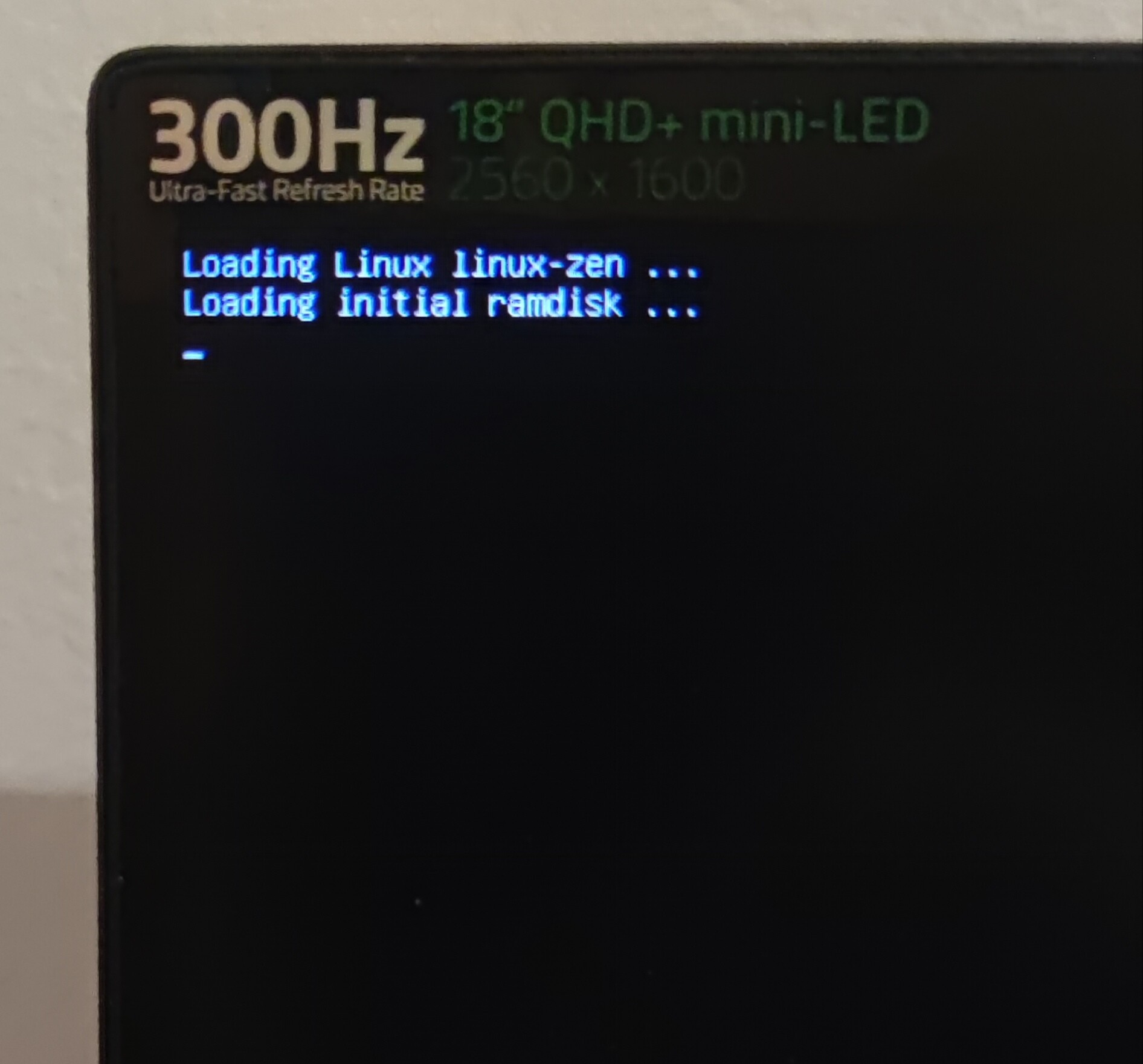

Okay, so I removed the config file.
Just to be clear, this is what I get:
So, unfortunately I cannot call a TTY here :frowning:
It goes past this screen on Wayland two times successfully, but on X11 it hangs here. I am not really sure what this is.
I tried clicking any buttons on my keyboard, but to no avail.
