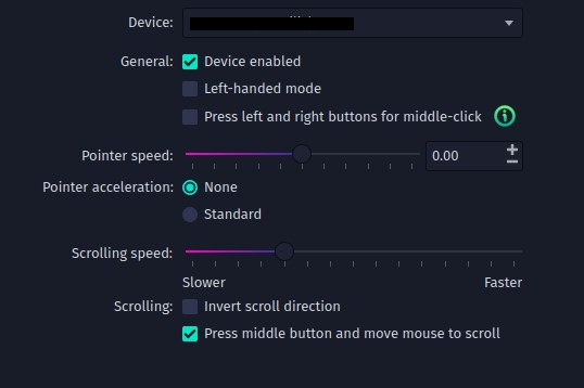

How to rebind button for on-button-scrolling
Is there a workaround to remap the button for the feature “press middle button and move mouse to scroll”?
I have seen a request for this feature on bugs.kde.org
(504013 – Add option to rebind On-Button-Scrolling from middle click to other keys.)
It’s gonna take a long time to get implemented (if it does), so in the meantime, I wish to know if there is a way I can do it on my own.
I have two side buttons on my mouse, and I wish to bind one of them.

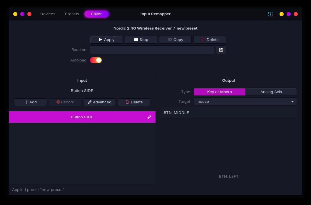

A more generic approach would be using input-remapper-git from the Chaotic-AUR. With that, you can pretty much remap whatever you want, however you want.
Example of mapping the side button of the mouse to the middle mouse button:
Select the device you want to remap on the first tab of the window (Devices). Then go the the Editor tab. In the left field (under Input), hit the Add button then the Record button and then you can press the side mouse button you want to map. Hit the Record button again to stop recording inputs.
On the Output side, Select the “Key or Macro” type. Target the mouse. In the field under that drop-down for the Target, start typing “BTN” and you will see selections; select “BTN_MIDDLE”. After that, you can Apply and save the config, and even toggle the Autoload.

Seems like it will remap the side button, to act as middle button.
The thing is many applications have different feature when you hold down middle mouse button. If I turn on scroll-with-mouse, those features get suppressed.

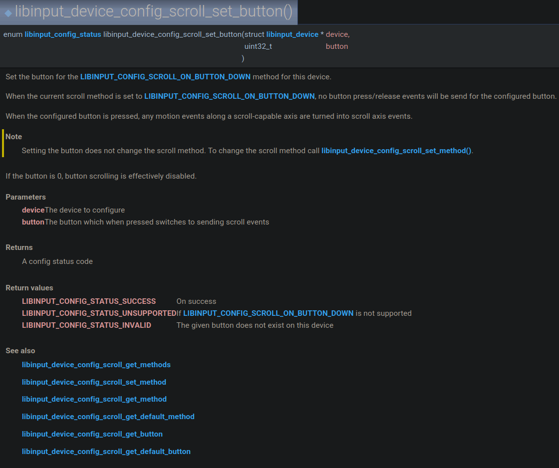

On other note, I did receive a reply from someone at bugs.kde.org, they said the following:
Libinput has this feature: https://wayland.freedesktop.org/libinput/doc/1.11.3/group__config.html#gac95a25055b22c3631e3c10c0463ca332
This link leads to this section of the page,
So, I now one more piece to the puzzle.

Ya… that makes things a bit difficult if it isn’t exposed in a GUI of some kind… not to mention, the libinput feature is disabled by default (and I’m not sure how to even enable that).
Looks like developers will have to fix this. I’m not sure of any workaround that can fix something like this, as like you said the middle mouse button usually gets intercepted by other commands from other programs for that button.
