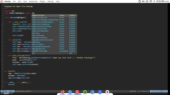

you need kite for development in which language? If its Python then 'Jedi' done auto-completion work out of the box, no need of kite. I am using Vim for python development using pre-configured .vimrc file. Here is screenshot, with Jedi auto-completion.
Kite isn't just autocomplete, but a more full predictive coding engine. I didn't find it that useful, but I can see why it's growing in popularity.
I know that the kite is not just auto-complete it uses AI to suggest predictive words. But I believe that AI no doubt gives you speed in writing code but killing his or her learning ability.
So I like simple auto-complete in which you have to write one or two letter to complete whole word.
