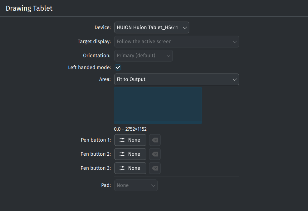

I have not, but i am left handed, so i need to flip the workspace, if i want to use any keys comfortably, which requires the driver.
Where do you go once in settings to set the keys?
In settings under the “Input & Output” section there should be “Drawing Tablet”, you can set the keys and even left handed mode from there.
This is under Wayland, last time I checked X11 needed the “wacomtablet” package to have tablet support.
Please try x11 as my huion kamvas pro will not work under wayland.
Also which tablet do you have
Thanks, i can use left handed mode, but thats it though, i can only change the pen keys, did that and tested, and it does not work, it just switched to eraser, but did not follow the custom keybinds.
Here i’l let you see for yourself:
I have a Huion HS611.
Noob question, how do i try x11?
At login screen , bottom left it will give you a choice to login with wayland or x11 :smiley:
