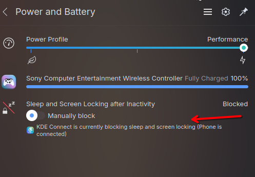

meta, as in - I do not want someone to post a solution to my specific problem of my PC not going to sleep (there may be many causes for this, but that is a separate question), but I want a way to figure out whether/which program is keeping my PC from turning off the display.
I want a tool to figure out what’s wrong, not a specific solution that probably won’t apply to anyone else to a specific problem that nobody else will likely have.
Does the state of my system affect whether there is an equivalent for windows’ powercfg /requests in Garuda or Linux?
…I’ll just post it anyway, to negate further questions about it. It really shouldn’t matter.
