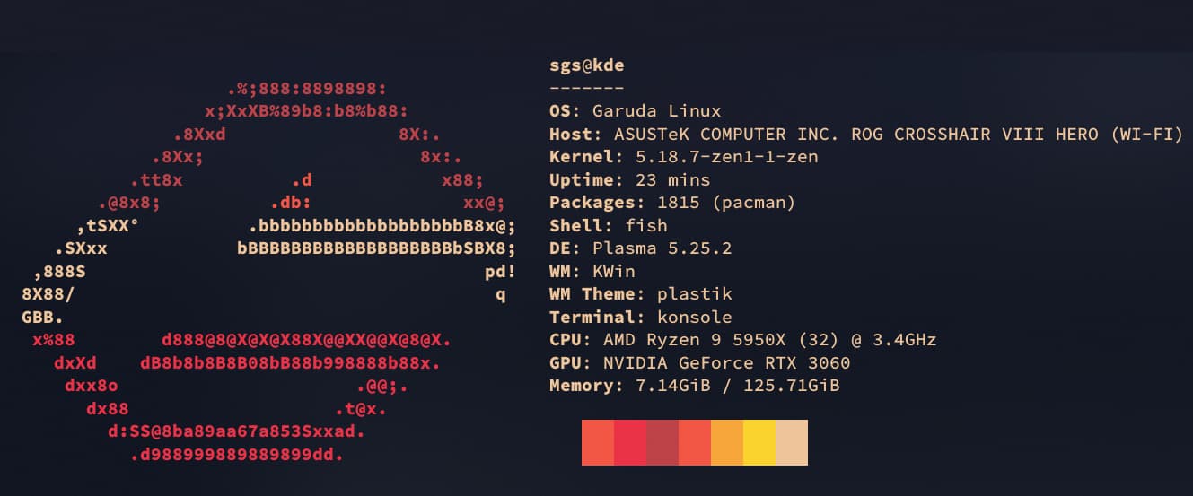

Hello Garuda users.
How do I change the Screenfetch on Garuda Linux, I'm still a beginner
To This:

The problem with all the *fetch stuff is getting the proportions right in the terminal output.
paleofetch, strange, I can delete all "G" arch.h but got the "G" ???
Sample, the Dragon Logo is very big. The output from paleofetch with the "G" looks
The dragon logo will blow up the terminal
All in all, there is no Dragon Linux either, even if Garuda KDE may look like it

Now that is one great logo!
A little squashed but I'd take it anytime with my fastfetch!
I'm using a long fastfetch which is longer than the "G" anyway so having that dragon there would be badass for me. I have no idea how to do it but it's on my list of todos.

Same here, big fan! Building a custom version sounds like an idea
Its very big but I try to make it smaler

Currently using this but what disappointed me is that neofetch had multiple colours and fastfetch was only red which is boring. Couldn't figure out how to change it tbh although I looked through the config
FF_LOGO_COLORS(

Feel free to change the red to more colors like in gentoo logo.
fastfetch --list-logos
fastfetch -l garudadragon
fastfetch -l garuda
Just pushed to github.
I forget to post the link to builtin.c
You can add only the standard ascii colors (in all “fetch”).
And you must build the PKG on your PC and install it.
There is no config to change the colors.
