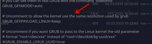

Someone is going to beat me with a stick for this (and I think I know who)…
It should be possible to modify the boot entries with grub-customizer to include this. Don’t know how well it sticks after updates, though.
Or, you could work your way through the grub configuration files (An introduction to GRUB2 configuration) to maybe find a more persistent way to force it in there.
Make sure you have a bootable USB stick ready…
!!! Never use grub-customizer !!!
But if you use the internet + searchengine you find itself.
Perhaps you take a look there and read point 4.1
And inside garuda we have a gui to do this also.
Garuda Boot Options " kernel parameters ":upside_down_face:
Are those per entry? Seems to me it’s always the same regardless which entry I choose.
This is a kernel boot parameter (for resolution over framebuffer/gpu).
Do you read point 4.1 ? I mean not. You can insert or changing there what you need.
If you have insert → save → run update-grub → reboot → and ?
Inside GARUDA you can use the gui.
Garuda Boot Options make this for you, if you insert/change there parameters.
