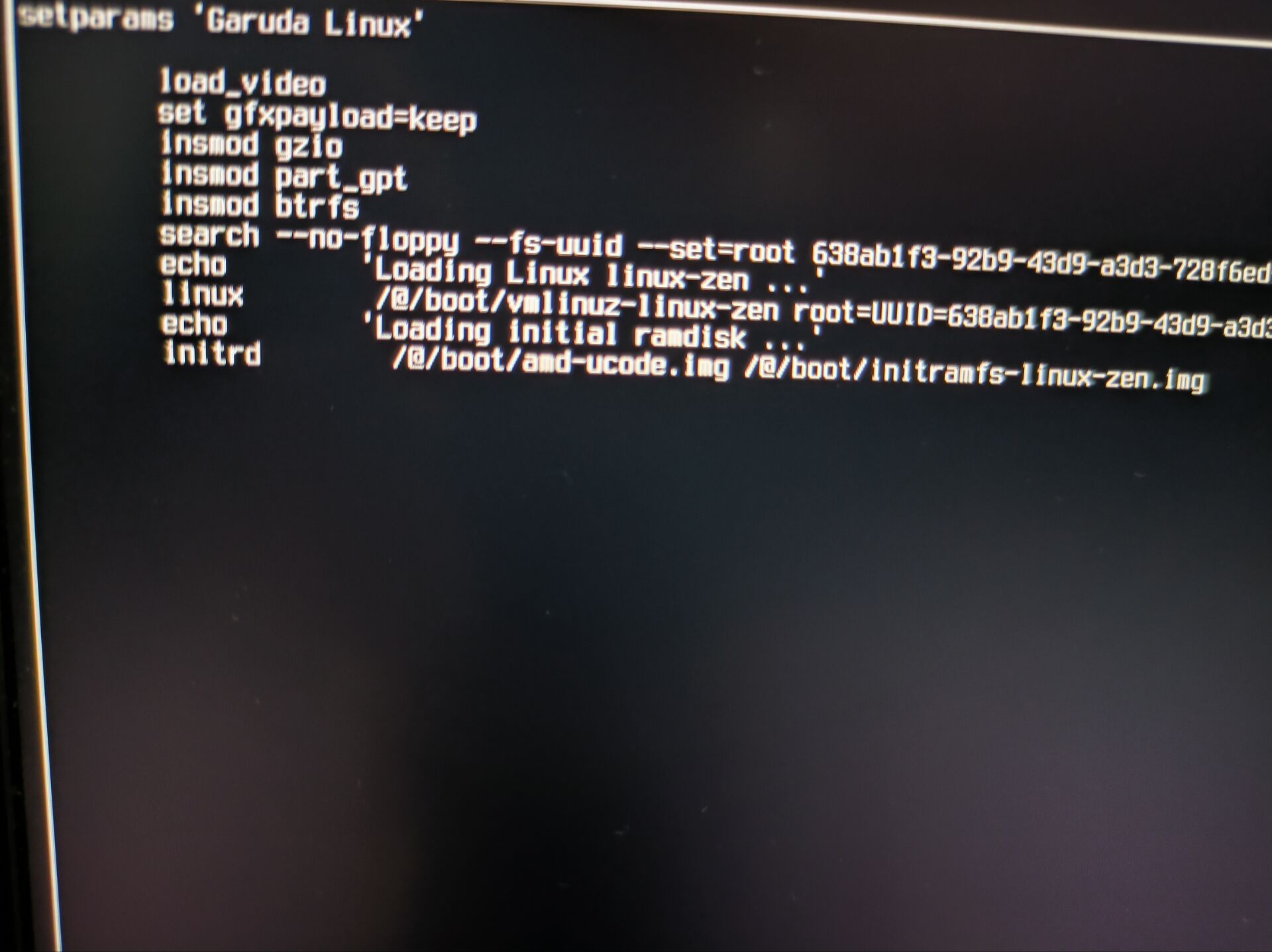

A shot in the dark: try adding atkbd.reset i8042.nomux to the kernel parameters.
No need to edit anything at this point, when in GRUB (by the way, does laptop keyboard work in GRUB?), press e and add it at the end of the kernel ... (:man_facepalming: ) linux line (beware, it likely wraps because it's long) then proceed.
You may have to use the external keyboard if it doesn't.
edit: also try booting without the external one connected (disconnect soon after GRUB if you have to use it there)
which line?linux ?initrd?
I added atkbd.reset i8042.nomux but it seems not saved.ctrl+x to quit,how to save then quit.
Btw, I can use my laptop keyboard in grub.
Apologies, memory failed me. The linux one, not kernel.
It does not save anything anyway, it only applies it for the current boot, so you can test if it makes a difference.
