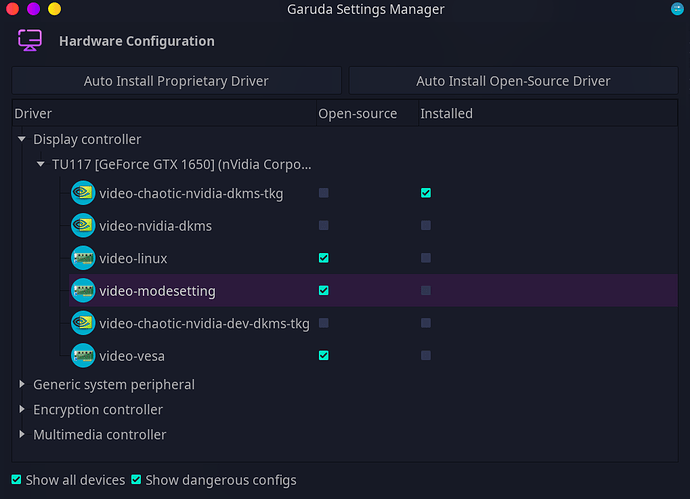

How do I know if I need nvidia-chaotic-hybrid drivers?
I have an AMD Ryzen 7 board with nvidia GTX 1650 and I read that apparently I should be running a hybrid video driver hybrid-amd-chaotic-nvidia-dkms-tkg-prime-render-offloading.
At the moment after I booted with nonfree driver from USB stick and installing Garuda and then many upgrades in the following days I never had those drivers installed, I have this:
I wouldn't be asking the question if I had no issue, right? I do. I noticed recently openGL drops frames, not sur if following an upgrade or what I have to test from USB again and another disk.
I spent now almost 10h reading and testing stuff and couldn't change that frame drop behavior a bit, except if I downgrade from openGL 3.1/2.0 to Xrender and then loose the important Blur effect and 3D renderings. Blur effect is quite important in Garuda! That test tells me it's somewhat related to openGL, no matter its version.
I do not have screen tearing. I have frame drops. Including the mouse cursor when I move it.
Now I'd like to know maybe I need those Hybrid drivers?
I don't want to click AUTO INSTALL PROPRIETARY DRIVER cuz when I do that when I reboot I get a blank screen and I am stuck there, no TTY swapping possible.
Would pacman -S hybrid-amd-chaotic-nvidia-dkms-tkg-prime-render-offloading be sufficient to install them or I need more to do it clean? I'm pretty sure I need to do more. :slight_smile:
That doesn't mean it will fix my issue but I want to test that driver and see, especially that I've read here on the forum this hybrid driver seems to be suggested many times, so testing it will add more information to the analysis of my issue.

I booted into a snapshot and tried the AUTO INSTALL DRIVER Garuda button again. This time it checked my hardware and told me I had the proper driver already installed, which is not the hybrid one.
I don't know if that means it would not be a good option to try the hybrid one on my case.
Hybrid drivers is for laptops
A'right that explains it all. lolll Thanks
