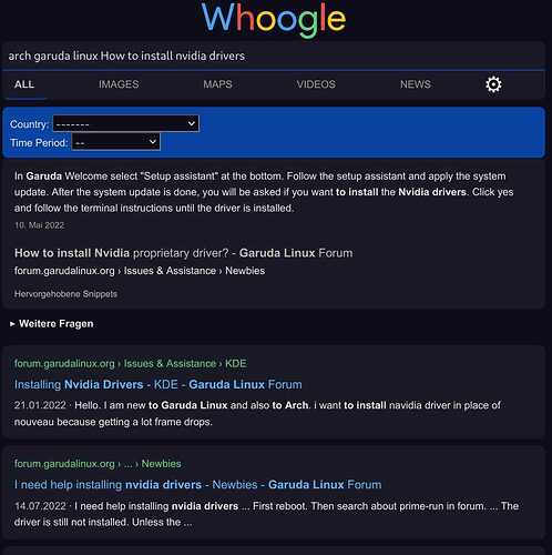

Why?
We always want the full version for DE and many other things.
And
In Garuda Welcome select “Setup assistant” at the bottom. Follow the setup assistant and apply the system update. After the system update is done, you will be asked if you want to install the Nvidia drivers. Click yes and follow the terminal instructions until the driver is installed.
