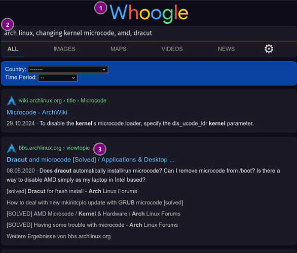

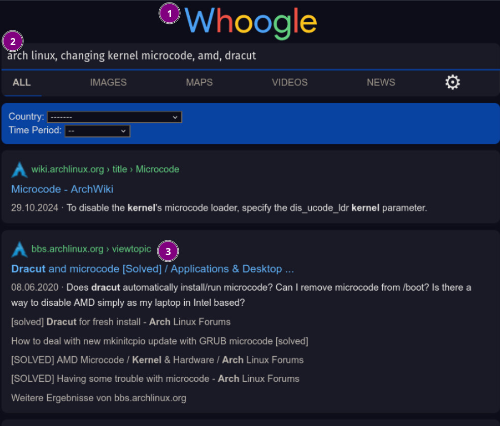

Did you check
https://wiki.archlinux.org/title/Microcode
Or you have to switch to mkinitcpio or ask the kernel developers directly.
Unfortunately, I don’t know much about it.
