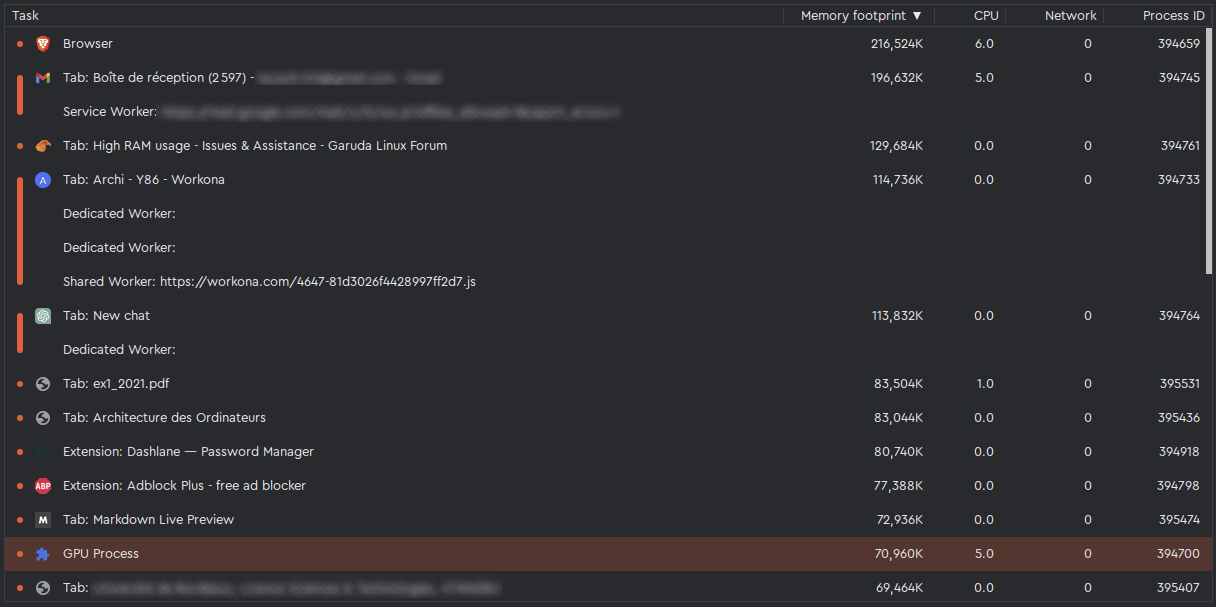

It seems that the tabs just consume more and more memory with the time.
This is the mem usage at Brave Start
200k heaviest tabs
100k average
80k fdp viewers
And this is when I have a High Mem usage
900k+ for heaviest tabs
800k average
