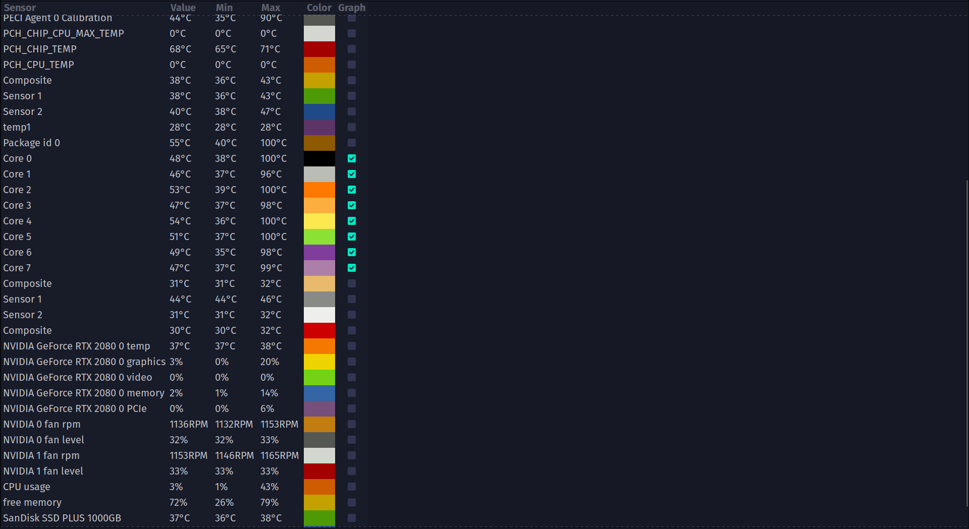

I can’t figure out what has changed, nothing in my VM configs have changed for months.
Idle in Garuda I am running around 45-50 Degrees C.
Start a VM and shortly I am up in the upper 80s and at times 90c. Stop the VM and I am back down. While I expect an increase, this obvisouly starts to set off BIOS temp warnings and CPU throttling.
With nothing running other than Windows 10 basic services and nvidia pass thru. Same issue on my Windows 11, nothing running but the OS and nvidia drivers basicly.
Again its been fine quiet sometime. AIO pump is working, CPU Fan per say is working. If I reboot to windows and use VM workstation I stay around 65 to 70.
Not sure whats changed in my Garuda setup to cause the increase in heat.
Any ideas would be great.
With VM Running:
With VM not running:

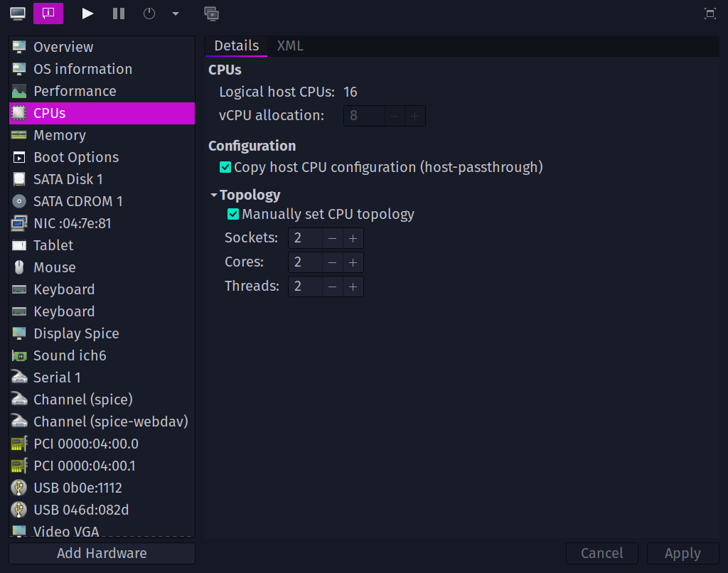

CPU settings in Windows 11 VM:
