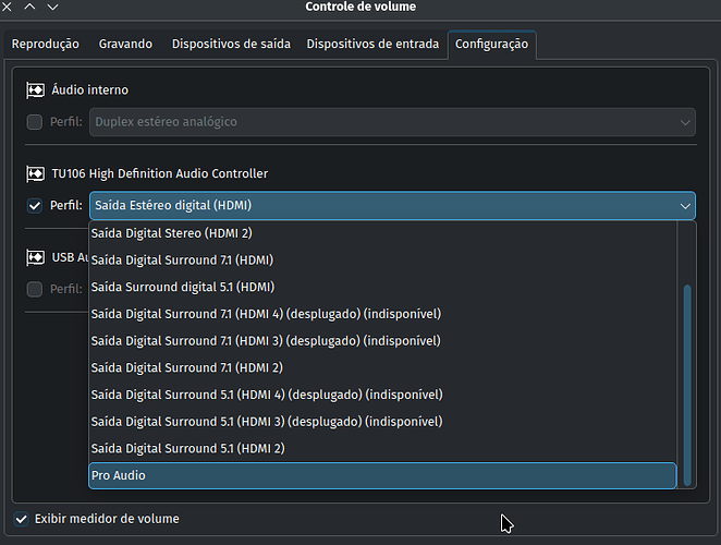

I can. The first one (Intel Cannon Lake) is my computer’s onboard sound; the second is the HDMI (and if I remember correctly, the DP also used an NVidia sound device); the 3rd one is a USB sound card dongle I use for my microphone which uses a P2 connector instead of a USB.
I can, for example, running Spotify change the output from onboard audio to HDMI, and vice-versa. But the DP connection won’t show up there…

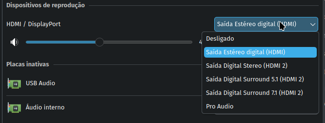

huh… I just noticed a “HDMI 2” profile on the Sound settings… and that outputs to the DP? WTH?

When you select the 2 profile, does sound come out of that port?
I think display port and HDMI share the same driver profiles on most video hardware devices. I know my old computer had Display ports and HDMI, but in windows, it would show up as just HDMI. I think that’s because the concept between these 2 types of video interfaces is just about resolution and refresh rates, the concepts between both are the same so they share the same types of drivers. But, don’t hold me to that, because I don’t know for sure.
yeah, when I select the “HDMI 2” profile, it works… but then the HDMI 1 won’t. The two problems I have with that are: it makes no sense that a DP interface be named HDMI to me? And I can’t use both simultaneosly…? Wonder if there’s a way to split the HDMI 2 profile into a different sound device…

I tried that, but since they are just different profiles of the same device, it won’t work =(

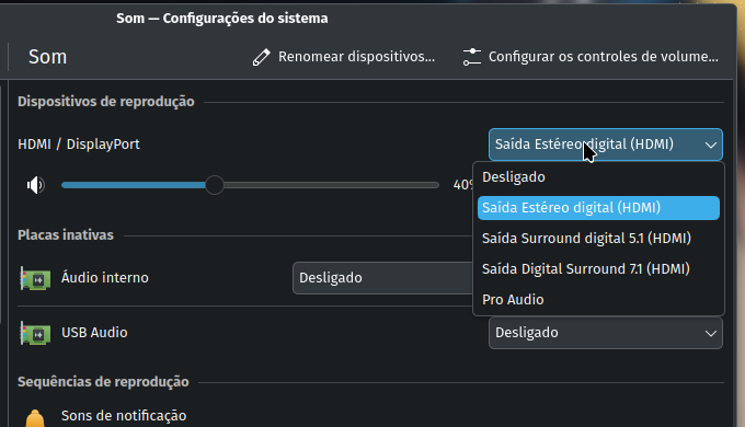

Some new profiles showed up, still showing both HDMI and DP on the laptop as HDMI and HDMI 2
But still, same device. There’s no “choose a different device for app” on the app part of volume control, I imagine because it’s a single device there…

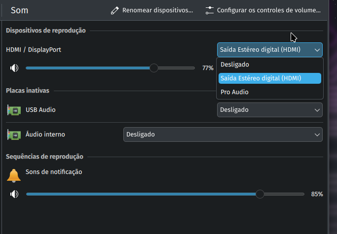

Moving DP to USB-C hub, the HDMI 2 profile disappears, but there’s no new device.
If I move the HDMI cable over there… it’s still the same =D
But now I’m getting a weird buzz coming from the HDMI display…? And testing won’t output anything :rofl:
(moving them back to the laptop ports, they’re back as profiles of the same audio device and working)
