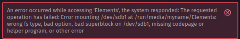

Please never post error outputs as an image/pic. If possible, always try to post errors as terminal output. Try mounting the drive from the terminal and then post any error output as text.
Images cannot be searched online effectively, so you are always going to recieve less help if you post errors in this manner.
