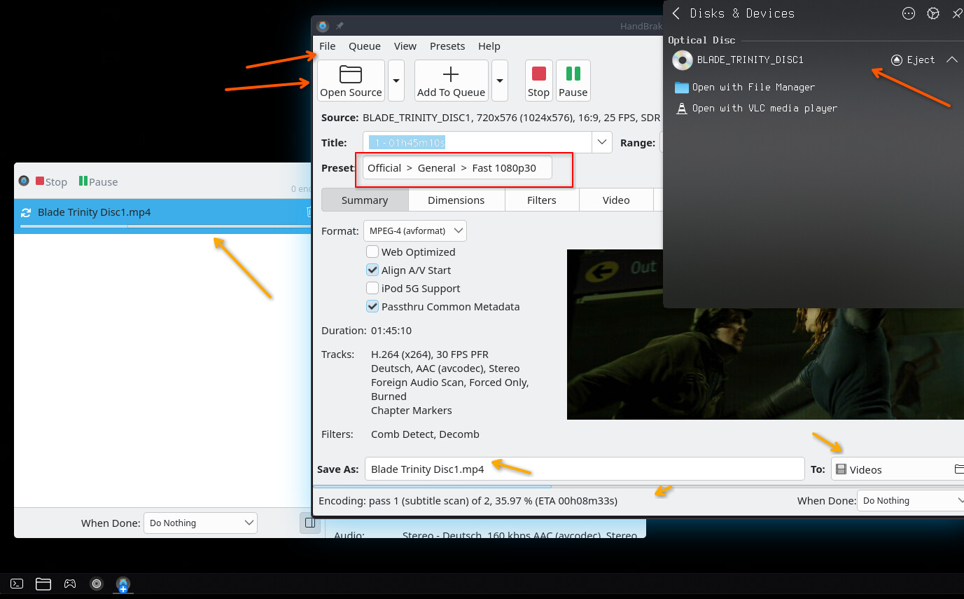

hi,
it is easy i dont think you would not get it done. So an example of my usage
Thanks!
So basically you are using the predefined presets?
As well a question wouldn’t be H.265 better than 264? :slight_smile:
Yes I use more 264 because not all my devices can read 265 so better if it’s on a usb stick . You can change them to your needs and test them if they working like you want. :wink:
