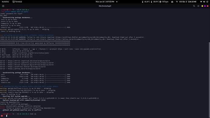

Found This difficulty when I went to update my system.
Terminal Pictures here...

I have the same problem with gtkhash. However removing doesn't work as it complains about
removing gtkhash breaks dependency...
How can I get round this problem please?
Cheers, Stephane
