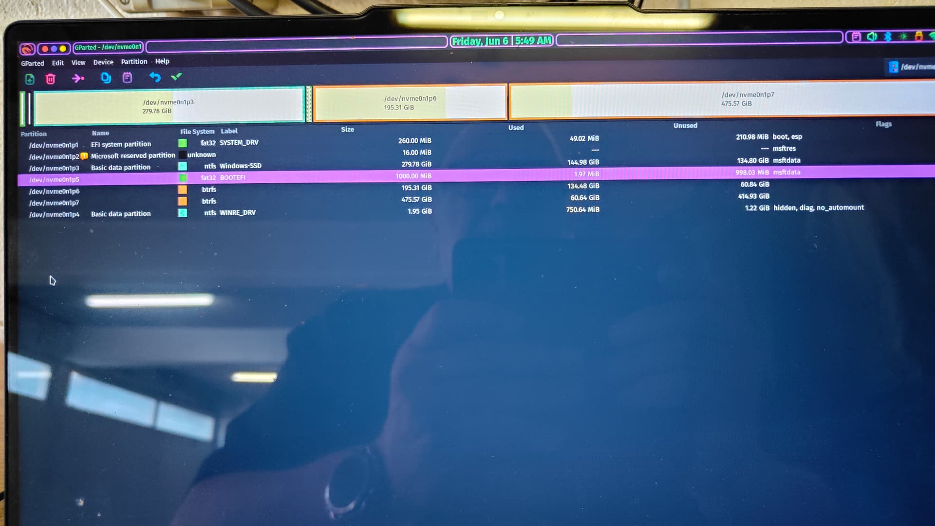

That’s what appens when i create a new partition with Gparted

That’s what i did
