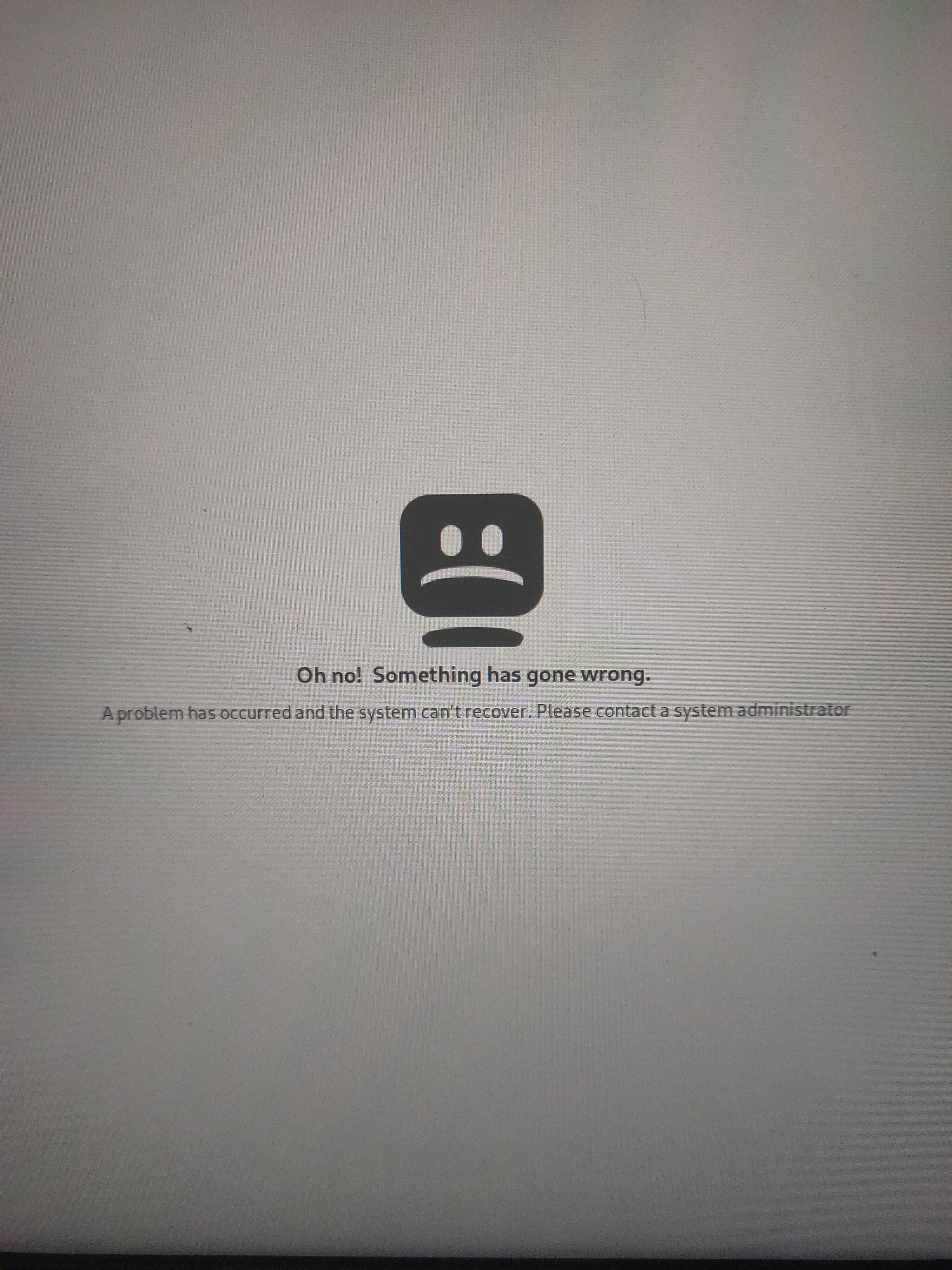

At this time i flashed gnome lite. First boot got successful everything seemed working flawless. I updated whole system and gave it a reboot.
Then on 2nd black screen occurred i thought it might be my video card isse so i wrote libgdm command and gave it a start again. Now this time following screen appeared.
It might be my pendrive check sum error. Because for lite also i got the same error from etcher.
Can you tell me how can i analyse my pendrive and system for error. There might be some command that will fix my both pendrive or something give me error regarding whole machine.
