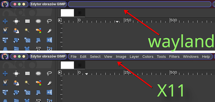

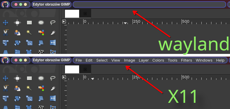

The problem occurs in gimp, inkscape, etc applications. Do you have any idea how to solve this?

Its a gnome or gtk issue the only way to fix it is add GDK_BACKEND=x11 as a environment variable. This only mainly works with inkscape and gimp any other gtk apps your mileage will vary.
To add this using the start menu R-click on inkscape/gimp etc click properties → Application → paste it in → click apply / ok and reopen it.
If kde pops up the window with all the apps you can just change them all at once and save. but yea depending on the back end toolkit apps use it might get worse down the line.
GDK_BACKEND=x11
It works grade!
Thanks.
