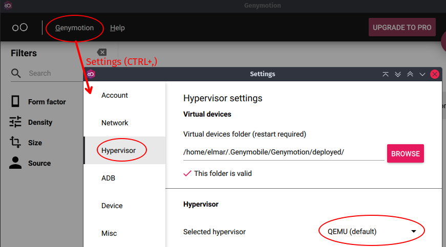

Okay, I apparently had selected VirtualBox as the hypervisor (emulation base) in the Genymotion settings.
VirtualBox does not work anymore. It needs to be QEMU (which also came with my Gamer version of Garuda).
Here is my explanation how to change the hypervisor:
Summary:
  • use shortcut CTRL+,
  • choose “Hypervisor” tab
  • at the bottom choose QEMU as hypervisor (it actually is the sensible default, I had update problems with QEMU last year, so after my data crash I setup Genymotion with VirtualBox back then)
Now, Wifi connection works.
