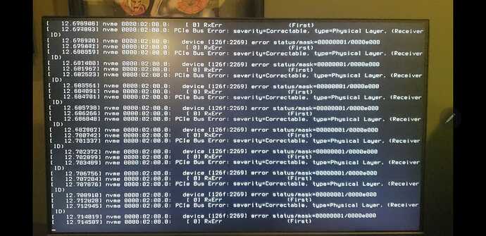

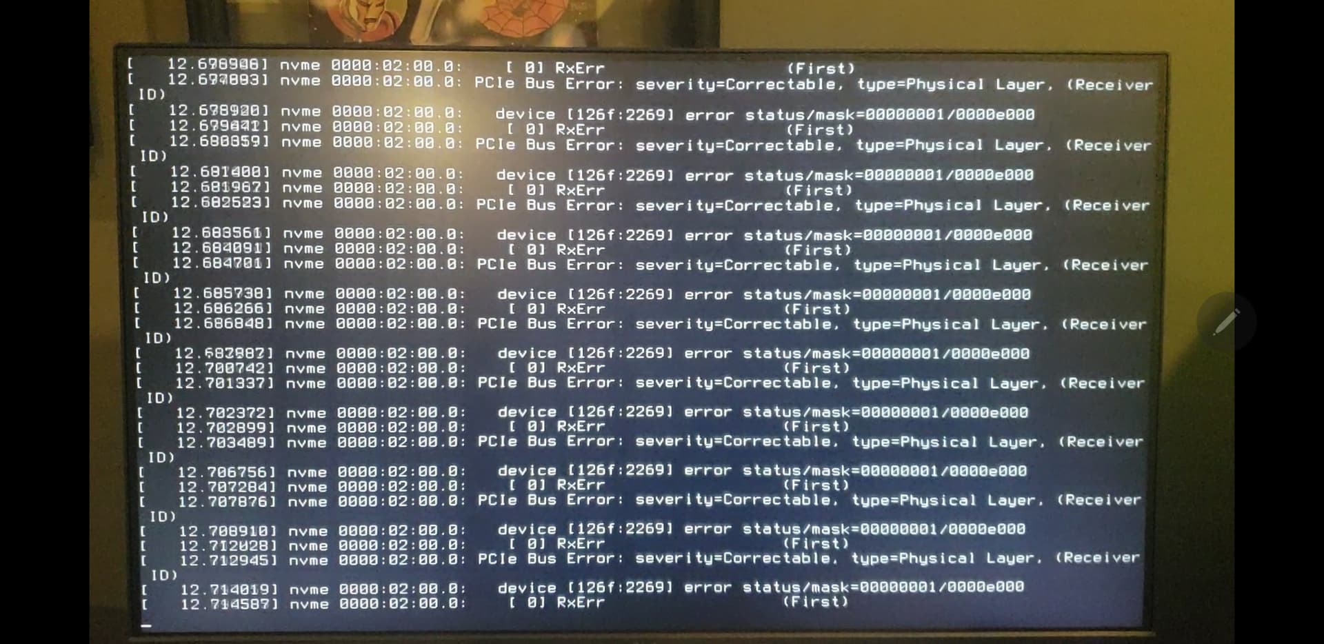

I just tried xfce and received the error <PCIe Bus Error: severity=Correctable. Type=physical layer. (Receiver>
What is after reciever is cut off by my monitor
But what might be the fix with this knowledge?
Please, no pictures from terminal.
Images can be read worse, are not searchable and copyable for further search.
Great, that’s the first useful hint. This indicates that either the BIOS or the controller of the NVMe has not implemented the PCIe protocol correctly. The linux kernel tries to implement this specification exactly, while windows doesn’t really care - that’s why windows boots with the NVMe but Linux does not.
Remove the NVMe again, boot your installed Garuda, open the “Garuda Boot Options” and add the kernel parameter pcie_aspm=off. Then test whether Garuda boots with the NVMe installed - if not, try the following kernel parameters (first individually, then you can also combine them for testing): pcie_port_pm=off and pci=noaer.
