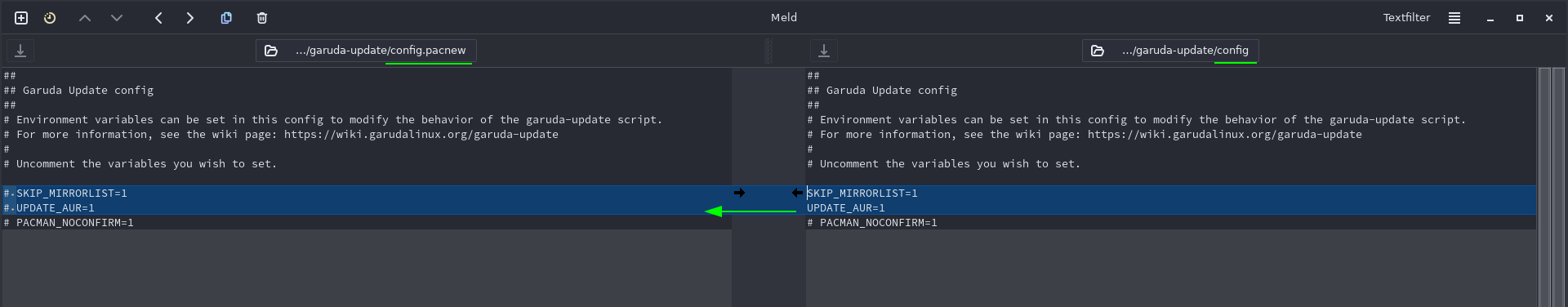

This sounds very much like it shouldn’t happen. Currently, drop-ins are not supported as far as I know, but they would be a great solution to this particular issue. Even better would be providing the default in another place, so /etc would be the user-chosen configuration.
I have basically set that file as immutable so that updates don’t affect it.
sudo chattr +i /etc/garuda/garuda-update/config
to make it mutable and editable again,
sudo chattr -i /etc/garuda/garuda-update/config
to view the attributes of a file,
lsattr /path/to/file
I agree this would be a better way to handle this.
It looks like it may be as simple as adding a backup= line to the PKGBUILD: https://wiki.archlinux.org/title/Pacman/Pacnew_and_Pacsave#Package_backup_files
I won’t have a chance to get in front of a computer today (happy Thanksgiving everyone! :turkey:), but tomorrow I’ll take a crack at it.
Yes, this would be really good!
Thank you for your tip. This would be a workaround, indeed, but then whenever it adds a new option, like what happened recently, one would not notice it.
Fixed in garuda-update 4.3.3:
Very cool, thanks! :hugs:

Thanks, this was a quick fix. I can confirm it works:
$ paru -Q | grep garuda-update
garuda-update 4.3.3-1
