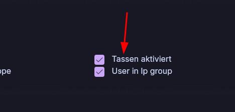

I’m shure some people like cups..but i mean “cups” inside rani (german-translate) is correct ![]()
@ Nico …all stuff with sane works

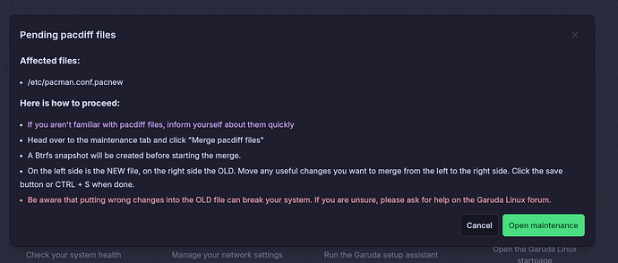

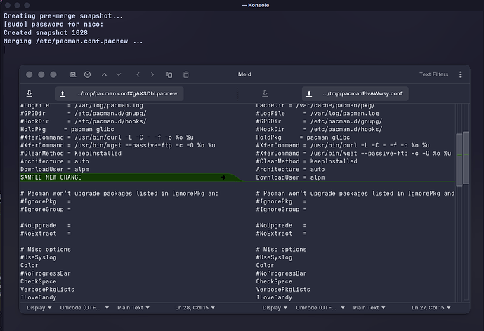

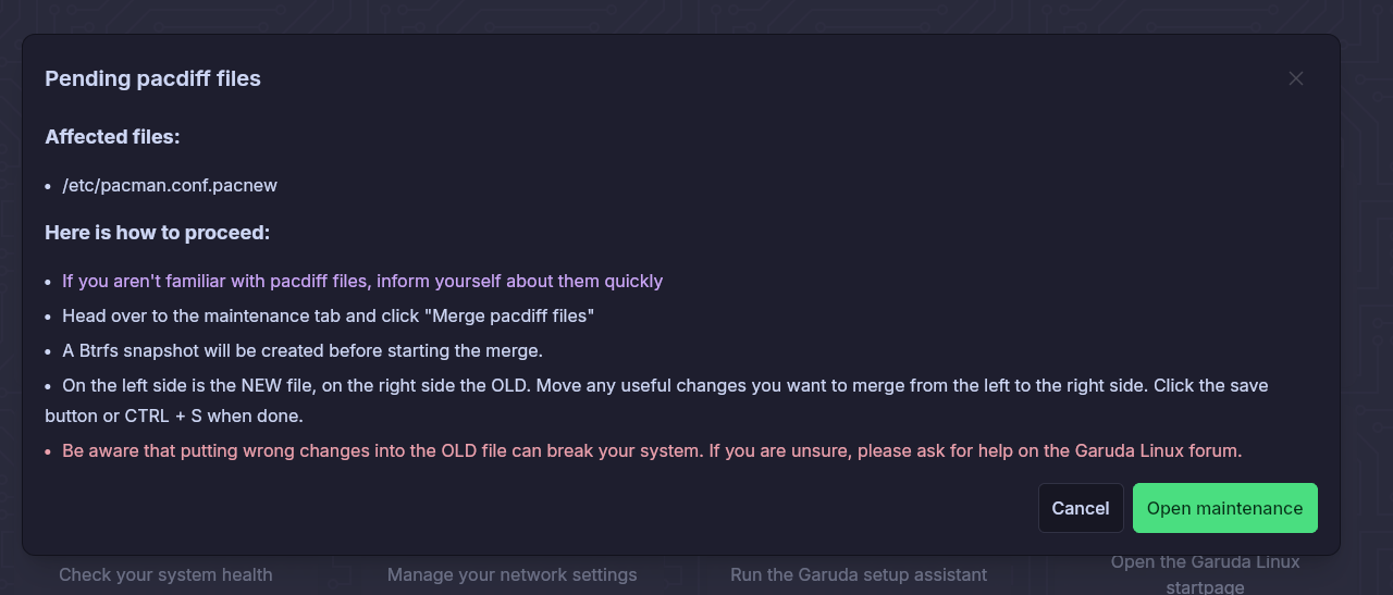

I found the problem, those 15 were not updates, they were warnings I had .pacnew/.pacsave files, so I used Garuda’s Rani pacnew/pacsave fixer,applied ‘update/fix all’ to the broken symlinks or whatever causes pacsave errors. It completely boinked my system, could not log in, seemed to have moved/removed all my config files, all passwords to everything were not registering, etc. I only had 4 backups and two were also corrupted by this and the other two got deleted as I rebooted and they were overwritten (note to self, increase backups.) I will now have to reinstall my whole system (insert big sigh here.) I will never use Garuda’s pacnew/pacsave fixer again. That should come with a warning!
What exactly did you do? It does not “automatically” do anything as it still relies on user input. Also which files were it?
I’d like to understand what was going on so we can either prevent user actions or make the needed actions more clear.
If memory serves, you have two options, one to go through each .pacnew/.pacsave one by one and compare the “broken or moved” symlinks, if that makes sense. It is hard to tell which is the correct one, which is why I chose the second option, to automatically “fix” all of them at once. Part of this of course is me not understanding what ‘could’ and ‘did’ happen as a result, however, to me, it is a dangerous tool unless you are very knowledgeable about .pacnew/.pacsaves and how they work.
In ArchLand, you’re expected to research, read, and learn.
Though your learning was somewhat painful ![]()
That sounds much like some of the system files were replaced with default ones or even emptied.
To be fair there were links to instructions for the compare tools in place, but yes, we should definitely put better warnings in place, or better even additionally make backups of the files (or a snapshot). I’m glad you had working backups in place.

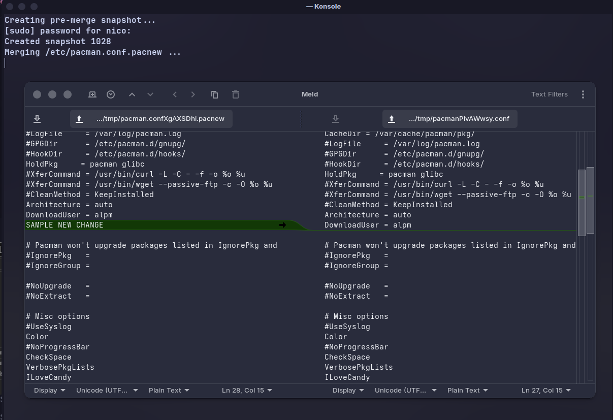

For the record: what tool did it use, kompare or meld? Multiple people already stated liking meld more.
Yes, I believe that is correct, it makes sense, they replaced the files with defaults. I did not see any links to instructions inside the GUI, or do you mean on this forum? I think better warnings and I love the idea of it backing up the originals. I had working backups (thank the gods for Timeshift backup on BTRFS) but I didn’t make enough backups to save me (my fault.) I need to rebuild/upgrade my PC anyways, so might as well get a fresh install of Garuda in the process. The universe was pushing me. ![]()
I am not for sure which internal tool it used to compare, as my PC is dead in the water atm…and my old brain is fuzzy on which I had installed.
I’m currently reworking that section for good. Kompare has been kicked in favor of meld. Now there are warnings in place and a clear instruction on what to do:
Also the hint to ask here for help in case it is unclear. Furthermore we create a BTRFS snapshot before doing any other action.
This should help make it better?

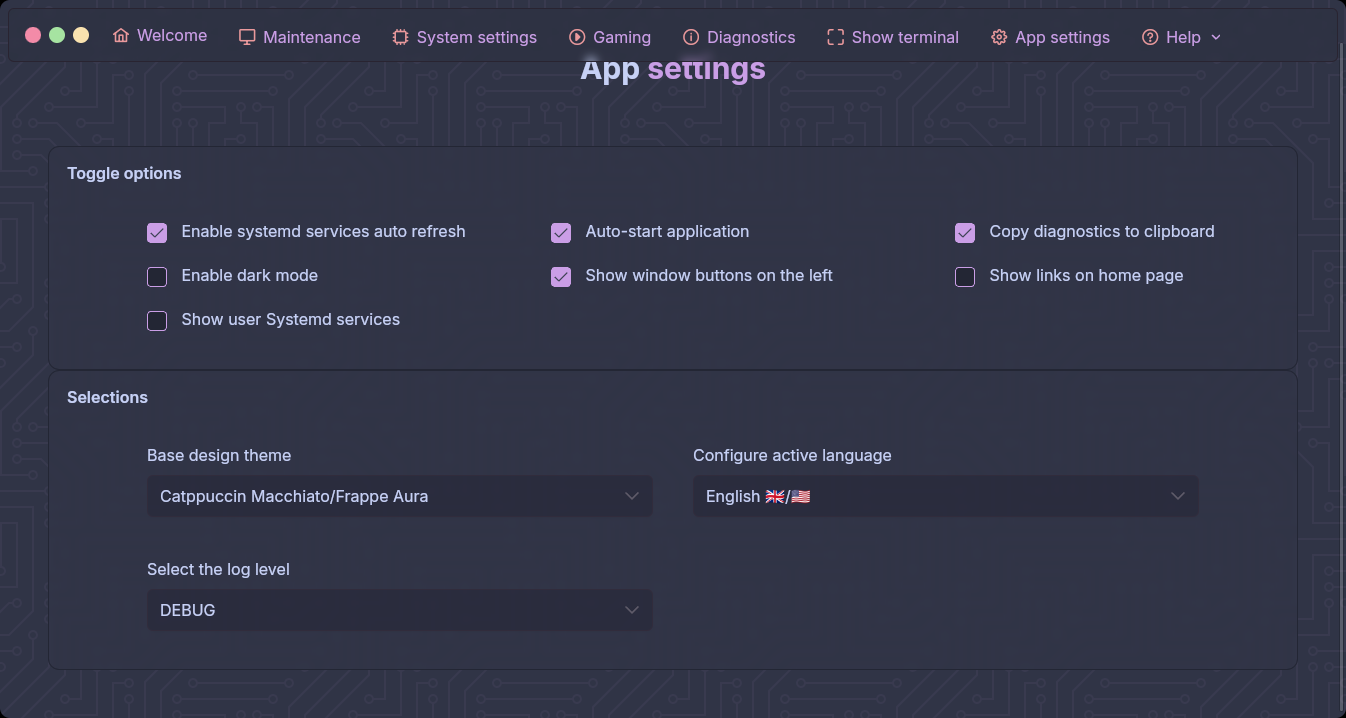

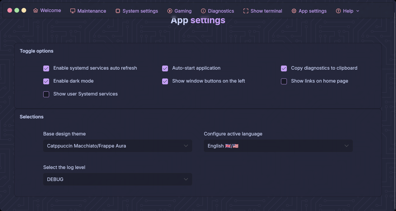

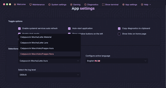

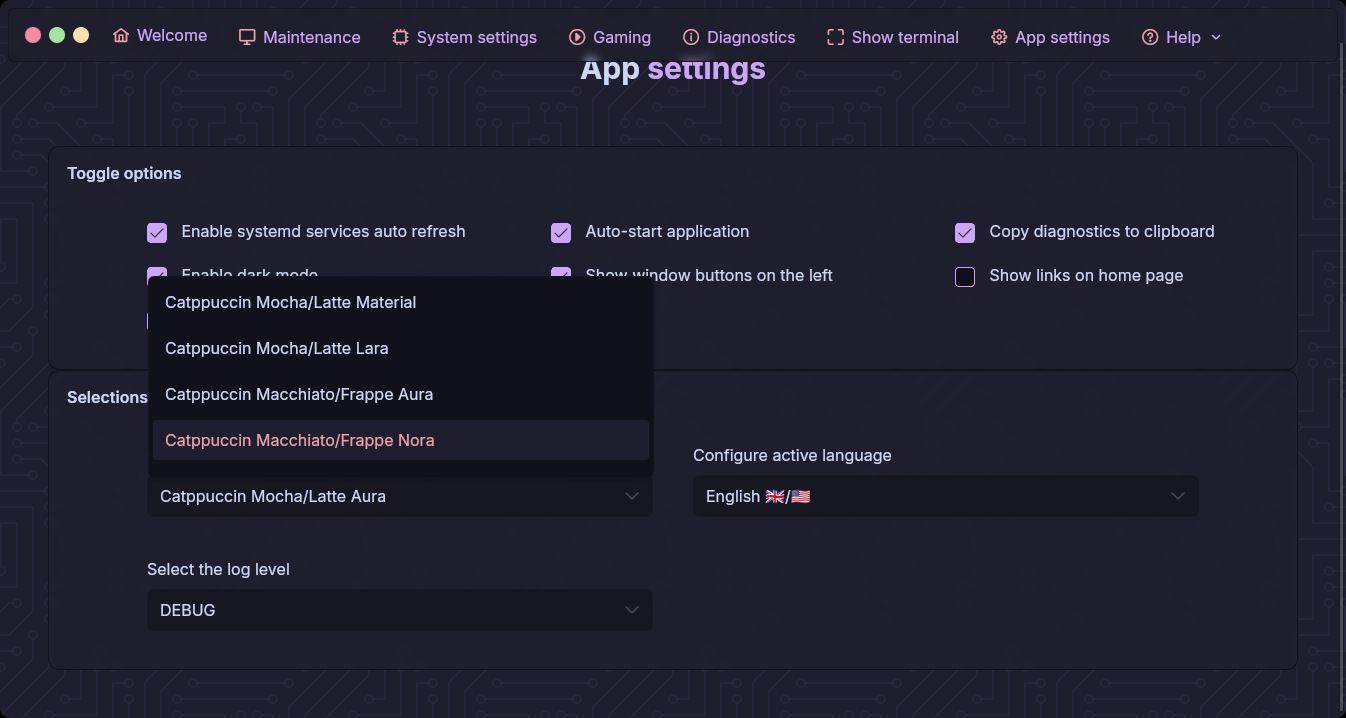

Theme variants!
Love it!! Thanks for making Garuda the best.
Nice work at all and i like it very much ![]()

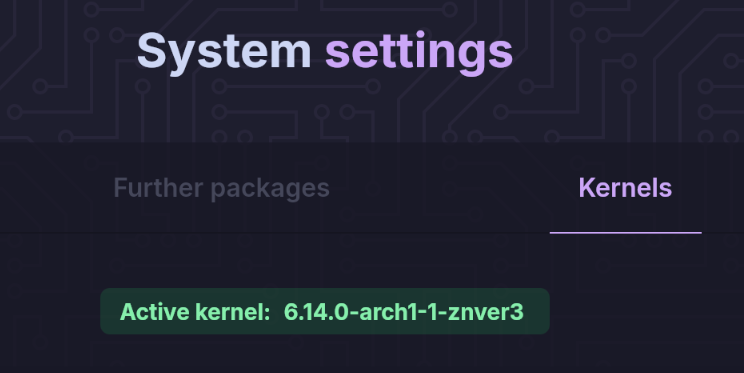

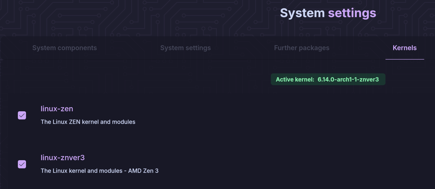

I dont know if its only on my rani if i have installed the lts, zenver3 and cachyos kernel it is not ticked with a hook to show its already installed. Im on Hyprland actually.
mhwd-kernel -li
Currently running: 6.14.0-arch1-1-znver3 (linux-znver3)
The following kernels are installed in your system:
local/linux-zen 6.13.8.zen1-1
local/linux-znver3 6.14-1
Reboot needed, the tick is also missing for the zen kernel.
Ups, seems it need some time ![]()

I was on rani after the update in the Kernel Section. It showed me activ kernel zenver3 and a warning any headers was missing. It didnt show me which one was missing to this point. So i waited and think it will be fixed soon. Did now update again and reboot and it showed me the linux Kernel arch 16.13.8-arch -1-1 headers. I have forgot to do a snipped pic but went in the terminal and sudo pacman -S linux-headers and it download and install it. Checked Rani again and the Warning was gone.
is it in rani before i did the terminal install only unhook execute and install again?

Want write this before i switch to kde what is not updated since yesterday and recheck it.
So checked my Kde
2.3.0.r19.g0448291-1 (outdated installed version is 2.3.0.r3.gf4ac52e-1)
Same issue only missing hooks in the older Version.
No linux kernel installed as no warnings.
Installed linux kernel then warning headers missing.(after reboot for sure)
Installed linux headers problem solved.(reoot)
So i dont know why it was on Hyprland only kernel installed and no headers because i know the headers are important. I did not remember it installed manually can be something else.
