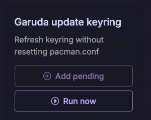

Would use Rani to update the Keyrings then run garuda-update and it would tell me no mirrorlist for the Cachy repos. Reinstall the Cachy repos, run garuda-update and all’s good. couple weeks later update the keyrings through Rani, run garuda-update and get the same thing. Couple of weeks later update the keyrings through Garuda-Welcome / Assistant, update via garuda-update and all’s good. This wasn’t a one off two different machines with three separate installs.

Though all Rani does is executing Garuda update functionality. Which toggle is it exactly that was used here? Maybe the following one?
https://gitlab.com/garuda-linux/applications/rani/-/blob/main/packages/renderer/src/app/components/maintenance/maintenance.component.ts?ref_type=heads#L175

I was investigating this again right now. If you click this, then some resetting is definitely expected. Garuda-update remote scripts are basically meant to be a way out when your system is ■■■■ed in one way or another (can even fix broken Pacman), which is also indicated by the tab being named “rescue tools”.
Because this happens:
this.logger.info('Running remote keyring');
return await this.taskManager.executeAndWaitBashTerminal('GARUDA_UPDATE_RANI=1 garuda-update remote keyring');
Which translates to:
if [ "$keyring" = true ]; then
    rm -rf /etc/pacman.d/gnupg
    rm -rf /var/lib/pacman/sync
    pacman-key --init
    pacman-key --populate || { echo -e "\033[1;31m\nFailed to populate keyrings\n\033[0m"; }
    pacman-key --recv-key 3056513887B78AEB 6D42BDD116E0068F --keyserver keyserver.ubuntu.com && pacman-key --lsign-key 3056513887B78AEB 6D42BDD116E0068F || { echo -e "\033[1;31m\nFailed to install some keys\n\033[0m"; }
    pacman-key --keyserver keyserver.ubuntu.com --refresh-keys 67BF8CA6DA181643C9723B4ED6C9442437365605 || { echo -e "\033[1;31m\nFailed to ensure some keys are up to date\n\033[0m"; }
    rm /var/cache/pacman/pkg/* || true
fi
    SKIP_AUTOSNAP=1 SNAP_PAC_SKIP=y $pacman -Sy archlinux-keyring chaotic-keyring --noconfirm
fi
After this, CachyOS keyrings are certainly gone. But mirror list should be still available (that’s being reset with another garuda-update remote command).
I’ve adapted the wording to be more specific about this fact, and also added a new “regular” maintenance option which simply runs pacman-key --refresh-keys.
This has also been fixed today.
