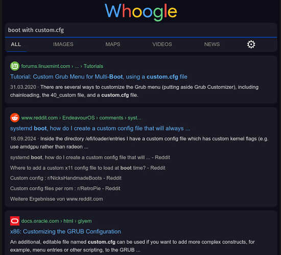

You can try also custom.cfg in /boot/grub
for grub or systemd boot

I think you should have taken the advice to create a custom boot stanza, to chainload systemd-boot from GRUB. I don’t think it will be long before the configuration you have described becomes broken.
