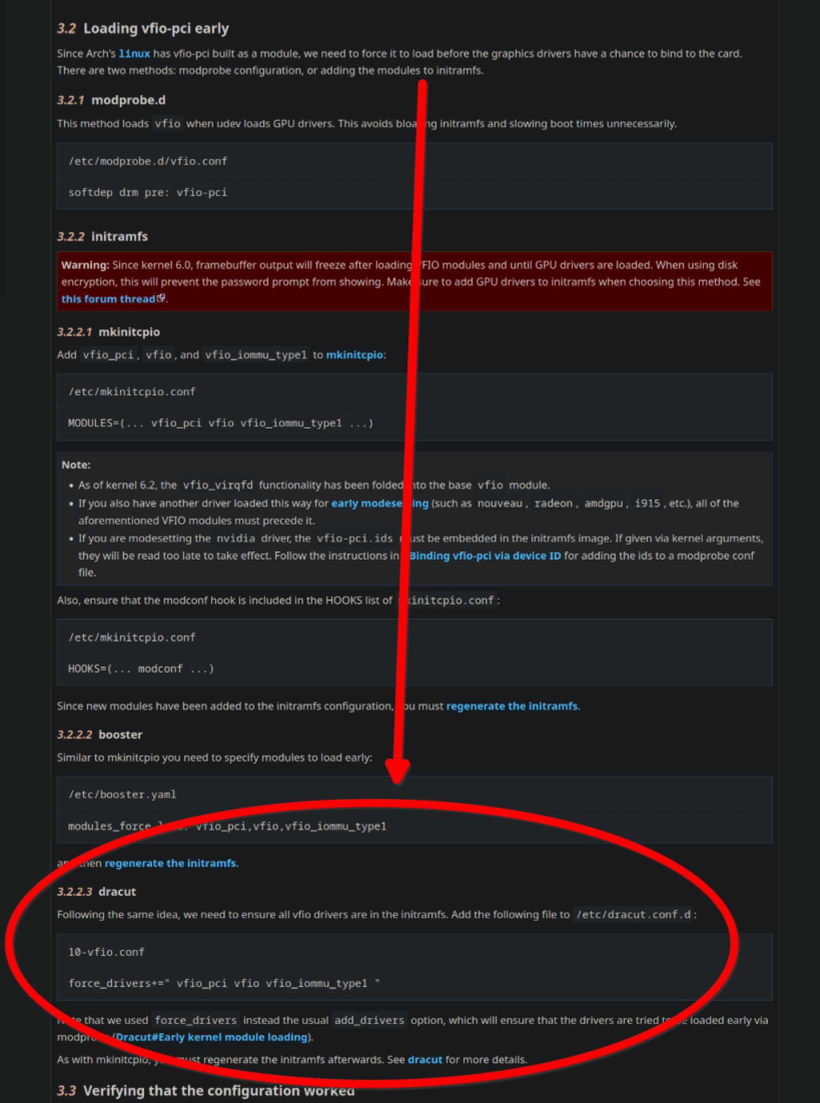

You have not given specific enough information for anyone to fully understand what is happening (for example, you have not posted the guides you tried to follow or the steps you have taken so far), but the one problem you specifically mentioned should be pretty simple to solve. Pretty much any instruction written for mkinitcpio can be done with dracut instead.

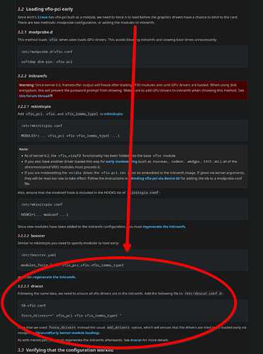

Again, you did not say what guide you are working off of but if it is this one, the instructions for dracut are actually printed right below the one for mkinitcpio.
Spoiler
Here’s a closer look:
Loading vfio-pci early
Since Arch’s linux has vfio-pci built as a module, we need to force it to load before the graphics drivers have a chance to bind to the card. There are two methods: modprobe configuration, or adding the modules to initramfs.
dracut
Following the same idea, we need to ensure all vfio drivers are in the initramfs. Add the following file to /etc/dracut.conf.d:
10-vfio.conf
force_drivers+=" vfio_pci vfio vfio_iommu_type1 "
Note that we used force_drivers instead the usual add_drivers option, which will ensure that the drivers are tried to be loaded early via modprobe (Dracut#Early kernel module loading).
As with mkinitcpio, you must regenerate the initramfs afterwards. See dracut for more details.
To rebuild the initramfs on Garuda, run sudo dracut-rebuild.

The ArchWiki article is not listing out a bunch of steps that all need to be completed–rather, several different possibilities for that one step are shown, and it is up to the user to decide which method they will choose. See here:
Then it shows an option for that first method (modprobe configuration) in section 3.2.1, and lists out three options for the second method (adding modules to initramfs) in section 3.2.2. The three options described are: mkinitcpio, booster, and dracut. These three choices all do the same thing; only one should be chosen.
All that to say: don’t set up a /etc/mkinitcpio.conf file unless you want to completely switch off of using dracut altogether, and configure your system to use mkinitcpio instead. If you add modules to an /etc/mkinitcpio.conf file but build your initramfs with dracut, the modules won’t be included.
