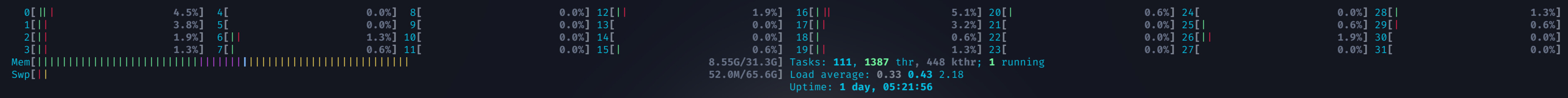

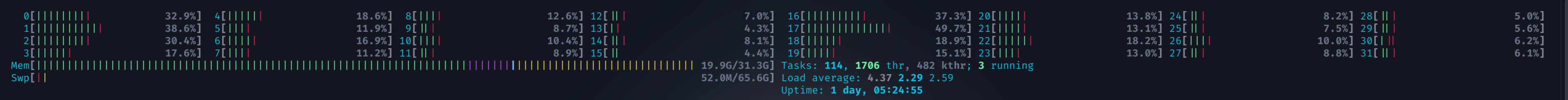

Here is the photos of Htop, Normal PC idle, PC idle with MC open (but not in world), and I managed to get one when Wayland crashes, it got frozen on the screen so I took a photo.
The pics are not very helpful because the lower part is missing and it is not clear what causes the most cpu/mem utilization.

I didn’t realize you wanted the bottom part of Htop, apologies.
