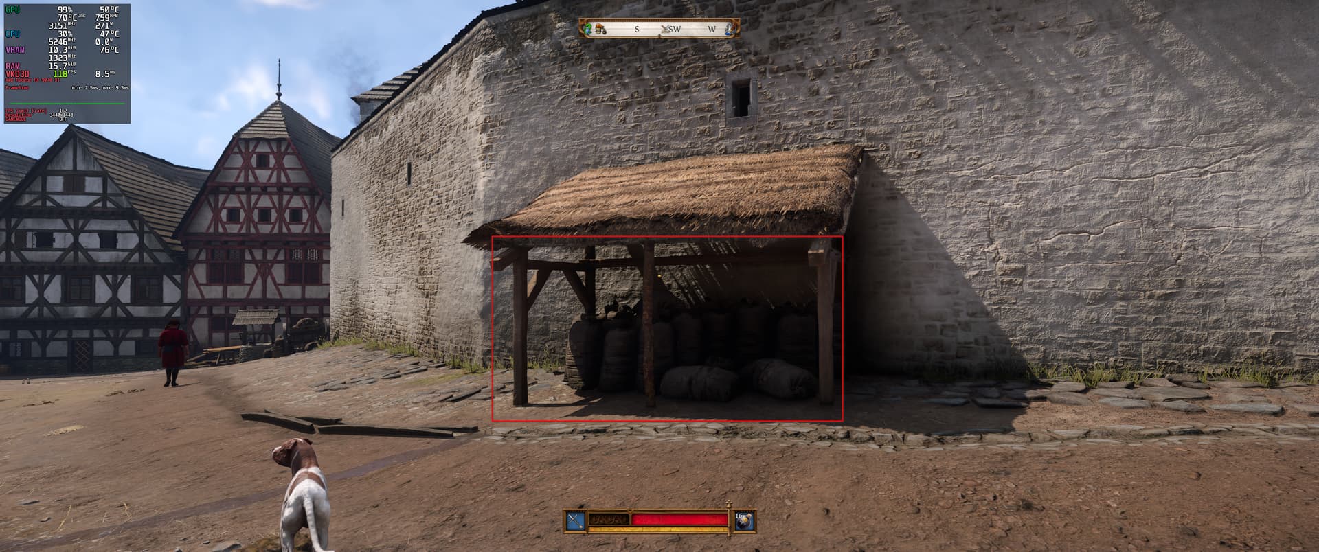

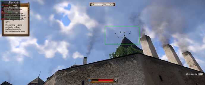

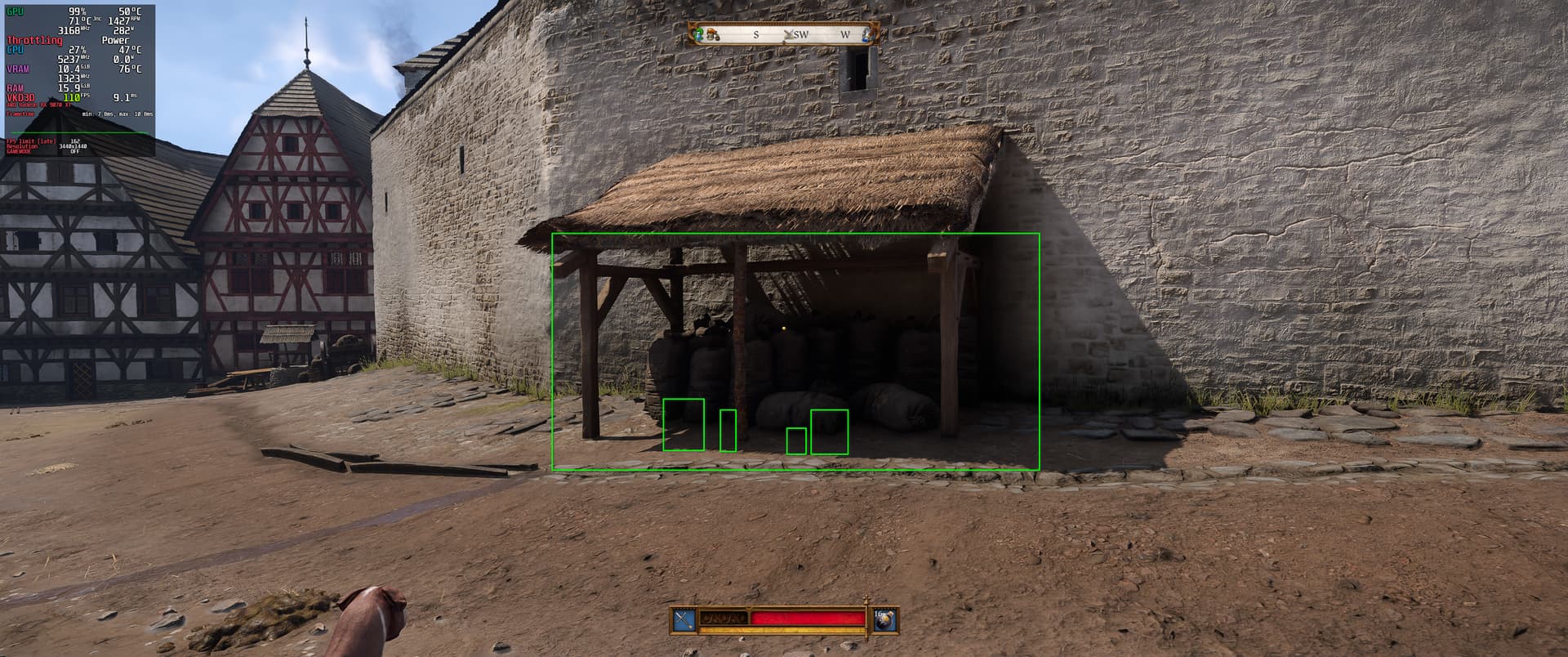

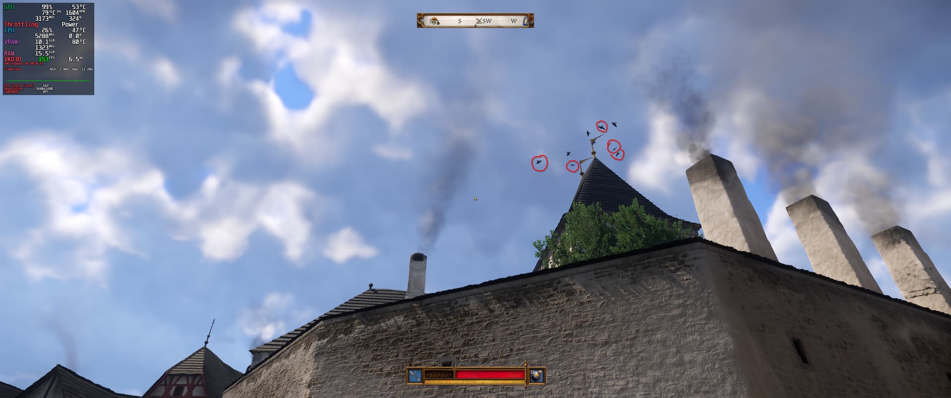

Here are some pictures showing the difference between FSR3.1 and FSR4 using the procedure above. I hope Garuda mods forgive me that I am using full size picture quality.
FSR3.1
FSR3_birds_ghosting
FSR3_water_drops_not_rendered
FSR4
FSR4_birds_no_ghosting
FSR4_water_drops_rendered
  1. As you can see the overall picture quality is overall extremely improved.
  2. Small details like water droplets from the roof are now properly visible to to relative distance of the game character.
  3. Small details like birds, leafs, water and others doesn’t have ghosting
