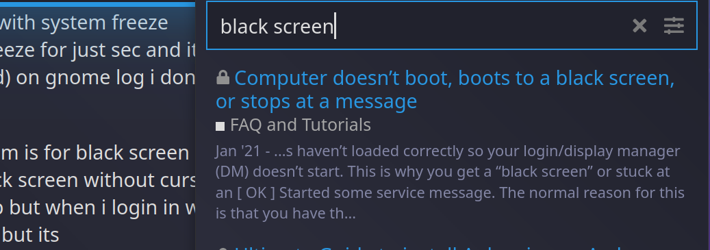

Before opening a new help request, please search the Arch and Garuda Wiki’s, and read any relevant sections related to your issue. Also, thoroughly search any error messages in the forum’s search engine and on the web. For in depth information on how to search for answers to Linux issues effectively read the tips on the Garuda Wiki:
And use search function :slight_smile:
