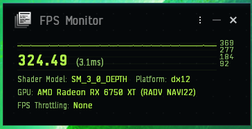

Fresh install, initial update, immediately shut down setup assistant, and reboot. Setup Steam, install/run Eve ...as it should my fps looks like this..
Screenshot from 2023-07-06 14-47-09

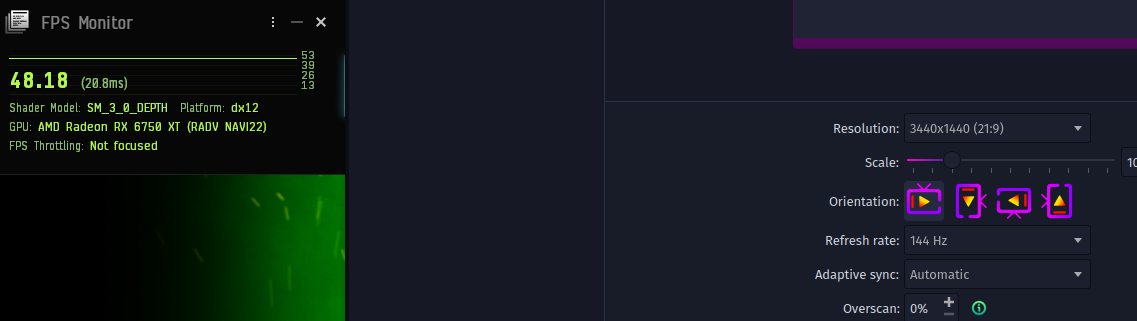

From there, I shut the game down, and just reboot my system, rerun Eve, and now the FPS looks like this...
I'm stumped. I'm not a dev, or a programmer, and I have no clue what could be causing this. And the bigger problem is that I can't reliably reproduce it. What I explained above is just one of the many times, over the last week, that I've encountered this, and at seemingly random intervals, and almost all of the information that I can find is either related to Nvidia, which doesn't help me at all, or integrated graphics, which I don't have. I'd really appreciate any ideas. TIA.
Are you booting to Wayland every time? Have you tried Xorg with the compositor disabled?
What does "FPS Throttling: Not focused" mean? Maybe you should direct your efforts to learning more about that.
I'm not running dual box. I'm not running more than one toon, and I have only one monitor. Also, as I mentioned, I'm only using Eve because it's a fast install with an FPS counter, it's doing this on all my games across steam and lutris. I have tried with only x11, I've tried with Wayland, i've tried the Linux zen kernel, the mainline kernel, the cachyos kernel. For some reason the culprit seems to come either during, or just after the second reboot, but I can't even say that for positive, because sometimes the second reboot doesn't do it. It's not even limited to Garuda. I installed Endeavour and Regata and had the same on that one. BUT installing a fedora based distro (Nobara) I didn't see this problem at all.

Lololol...yeah, I've tried turning it off and on again a few times, as well. Of varying lengths, even. From a few seconds to overnight. I even cleared the CMOS for no good reason, at all, because I knew that wasn't going to do anything. I give up. I just don't know enough about Linux, yet, for an endeavour like this. As much as I absolutely love this distro, and I really mean that, dr460nfire, and everyone else that works on this, have done an absolutely stellar job. I really think it's just one of those "arch problems" that I'm just not skilled enough for...yet. So, reluctantly I'm moving back to Nobara. Maybe in 6-8 months, a year, or so both Arch, Garuda, and I will have come far enough that I can confidently mess with it. Hopefully, by then, they'll have implemented Wayland in the install. Thanks for the help !!! :peace_symbol:
I mean, if anyone stops by and thinks they have an idea, I'm still open to hear them. I know it's not Garuda, because every single arch based distro that I tried did this to me. Either it's something in arch, or my hardware doesn't want to play nice with something in arch. I've since installed Nobara, got everything setup the way I want, installed and setup doom emacs, and everything still runs perfectly. I'm already halfway to making Nobara "look" like Garuda. I just don't get it.
