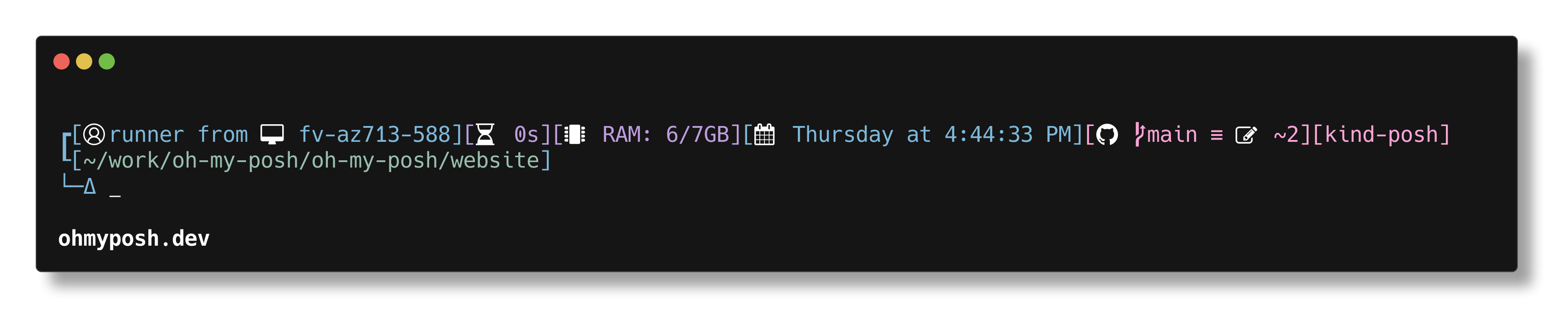

Just to be easier to show, this is how the theme was supposed to appear:
(from Themes | Oh My Posh)

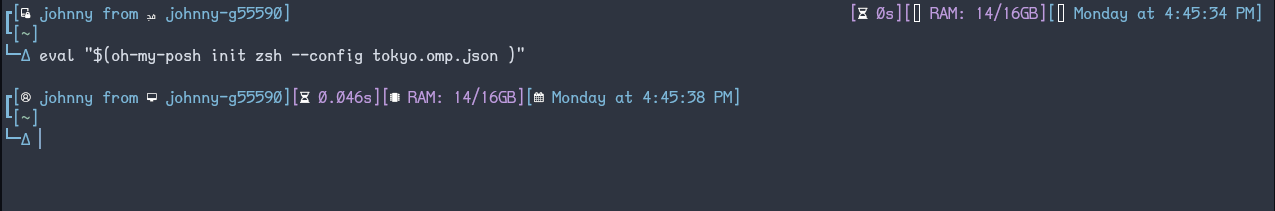

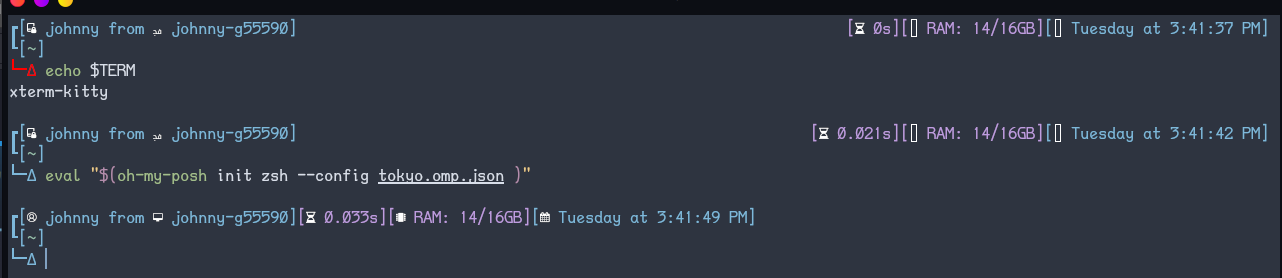

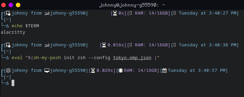

This is how it shows (Konsole on foreground, kitty on background):
I must say I never delved too deep on the workings of fonts on Linux, I mainly just used oh-my-posh’s font install command to do it, and it used to work nicely.

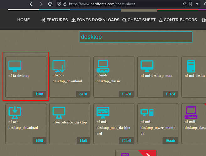

Also… f108 doesn’t seem to have changed?

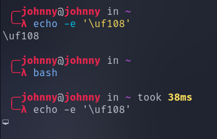

you know the funny thing? that idea sent me down a shallow rabbit hole where I ended up remembering about echo -e, so I tried echo -e '\uf108' and guess what?
Kitty:
on Konsole I had to first call bash, because fish.
so the font works. there’s something else broken in there, then… guess I’m taking this to Jan (oh-my-posh dev)
–edit
ahhh I managed to printf on fish =p
–edit 2

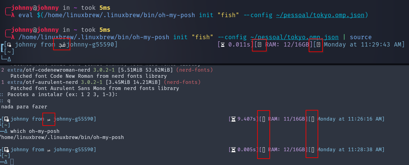

how bananas is this?
(for those who don’t know - I had already loaded oh-my-posh on the shell startup script .zshrc, and then ran the command, manually, again)
–edit 3

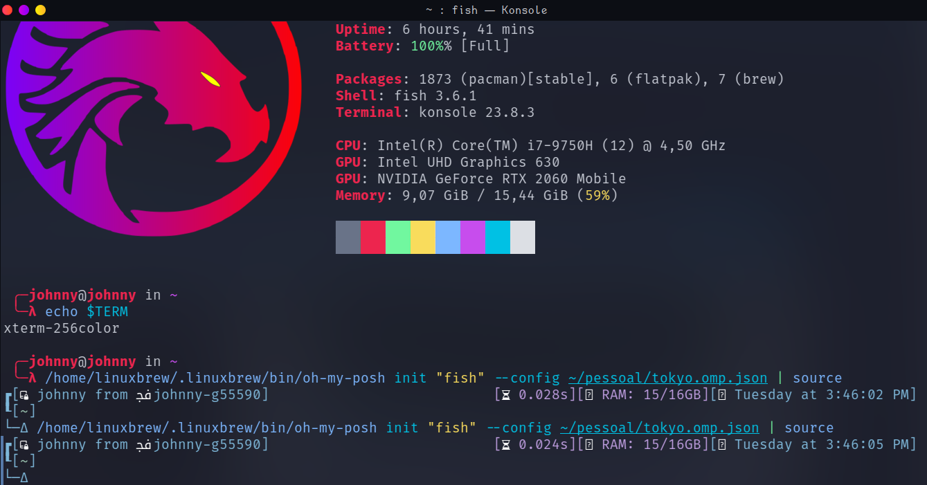

definitely not terminal related.
(Konsole fish just dislikes it anyway)
