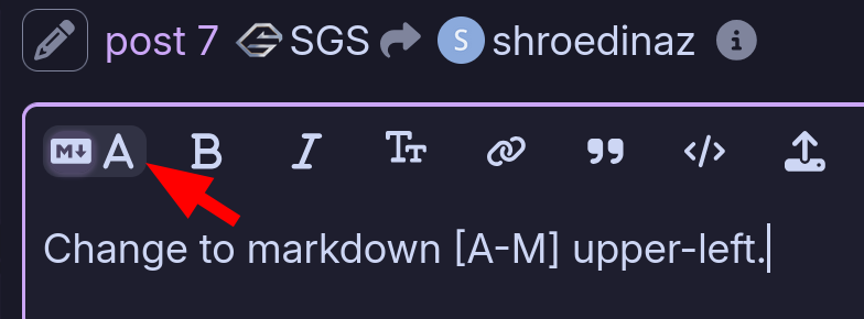

Change to markdown [A-M] upper-left.
So, should I uninstall fwupd? You’re solution pre-existed the fwupd upgrade.
My hint is just for the correct format from termial logs, I edit your post above.
