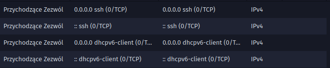

When I go settings->wifi and internet->firewall there are 4 rules in it. I delete them and everything works correct. But after reboot, those rules are back. I tried this few times and the rules are coming back every time. Is it correct? How can I delete them? Of course I save changes.

Thank you, I willa check the permanent mode. Anyway are default settings safe? They looks to allow any connections from any IP on all ports. When I delete those rules everything is still working fine.
The default firewalld configuration blocks all incoming traffic and allows all outgoing traffic. For typical desktop usage, this is probably what you want (you may not need to change anything).

The use of port 0 is unusual and might not be what you want. Typically, SSH runs on port 22, and DHCPv6 uses UDP ports 546 (client) and 547 (server), not TCP.

Can I delete those rules and leave it empty? I did it in runtime mode and everything still worked, so maybe it would be safer to clear those rules?
It is unlikely you will have any traffic that those rules would apply to, due to port 0 being specified like that. So yes, deleting those rules should have no effect.

I found out what’s going on. Those rules apeear because I set home area in my internet ![]()
