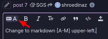

Please, format your terminal log.
Maybe:
Change to markdown [A-M] upper-left.
