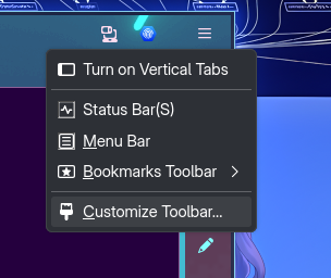

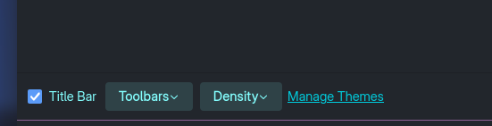

Firedragon QT seems to have stopped working/been removed
As of yesterday I updated my system and my FireDragon browsers header buttons (close, minimize etc…) seem to no longer be integrated with my system like they were before (KDE). Prior to this update, when maximizing FireDragon it would shift these header buttons into my top bar, but now it doesn’t work. I’m not terribly experienced, but I believe this was a QT implementation that replaced the default GTK buttons. Looking at the gitlab changelog for firedragon I see no mention of change related to QT. Did something break or was this intentional? I primarily used FireDragon because it was the only good browser with QT support, so this is rather saddening. Thanks for any response/advice.

Can you check the value of the “browser.tabs.inTitlebar” preference in “about:config”?
The value is 2 presently.
Can you try setting it to “0” (which is the default)?
Done. That did indeed fix it. I recently messed around in my about:config for a totally seperate reason, though as far as I am aware I never touched that setting… Hopefully this wasn’t my own stupidity. Thank you kindly for the assistance.
If it happens ever again you can just R click empty space by the address bar, click here, Customize toolbar.
Then click in the bottom left,
title bar and make sure its checked. This works for all but one firefox based browser
