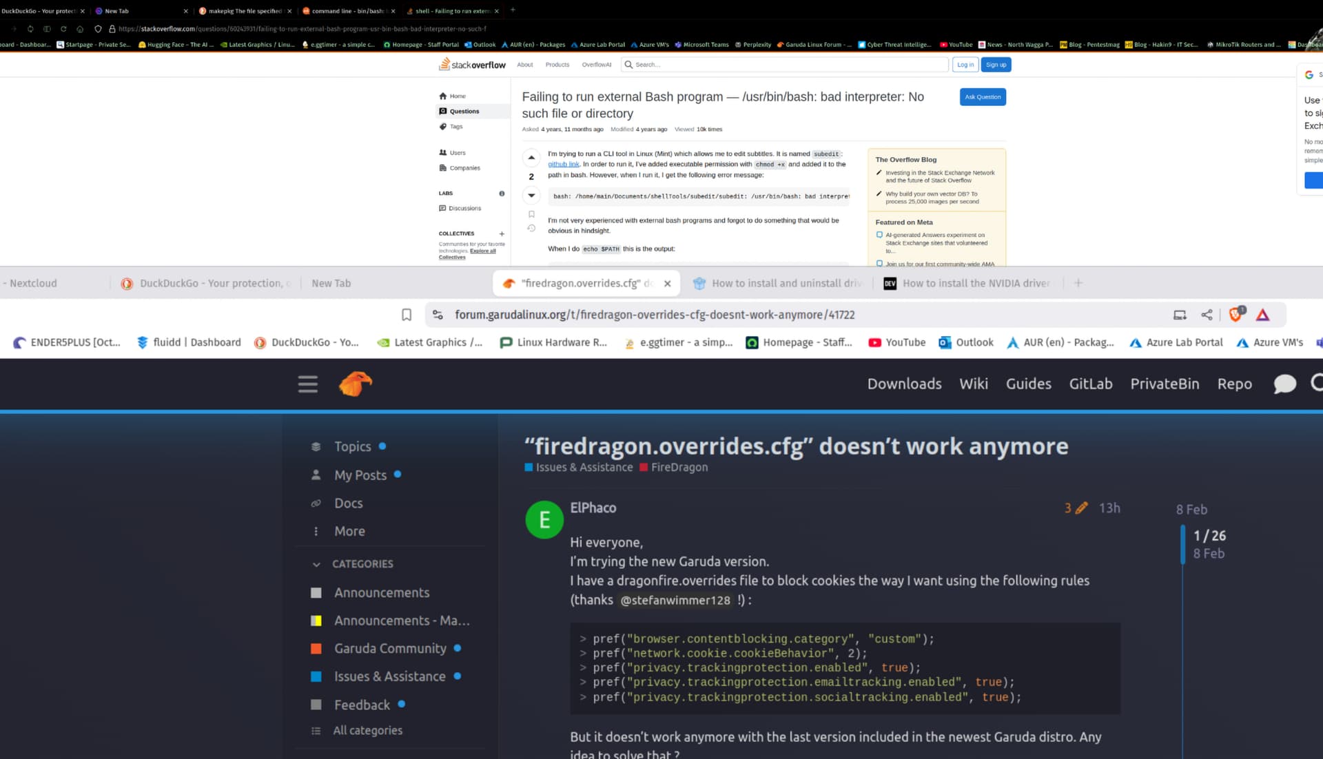

I cant seem to get Firedragon to scale correctly, I have a 2K monitor on my new laptop, I need to use display scaling to read the text (135%). This scaling applies to most applications except for firedragon.
I’ve tried to include an image, maybe I am not running in a Wayland compatible mode?
Any help Appreciated.
You can check if your running under wayland in about:support under “Window Protocol”.
If you are you can try enabling widget.wayland.fractional-scale.enabled in about:config.
Thanks for the help, the window protocol was definitely wayland and the fractional scaling was actually set to false. So I changed the value to true but there was no change unfortunately. Scaling still seems to be broken in my setup.
Did you try restarting FireDragon after setting the value? It might require a restart to apply.
