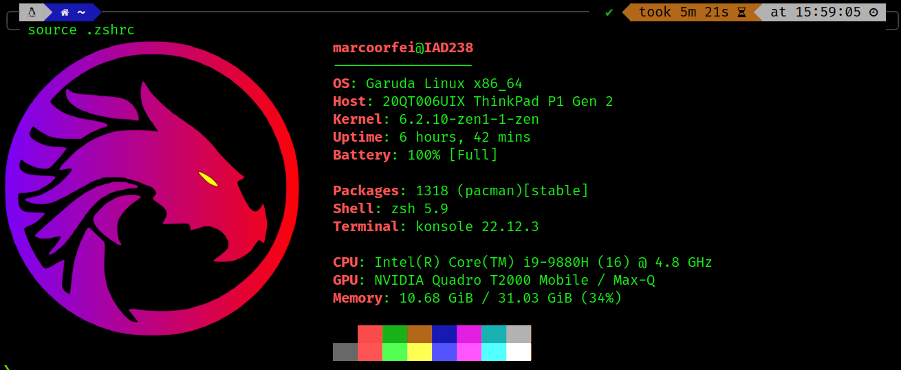

When i run the command:
source .zshrc
I get everything working fine (I see the correct Garuda Dr460nized logo and informations).

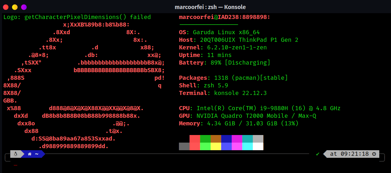

But when I open a new terminal session I have the following error:
Logo: getCharacterPixelDimensions() failed
and the Garuda logo is not visible (informations displayed are correctly).
How can I fix it?
Has anyone had the same problem as me and solved it?
