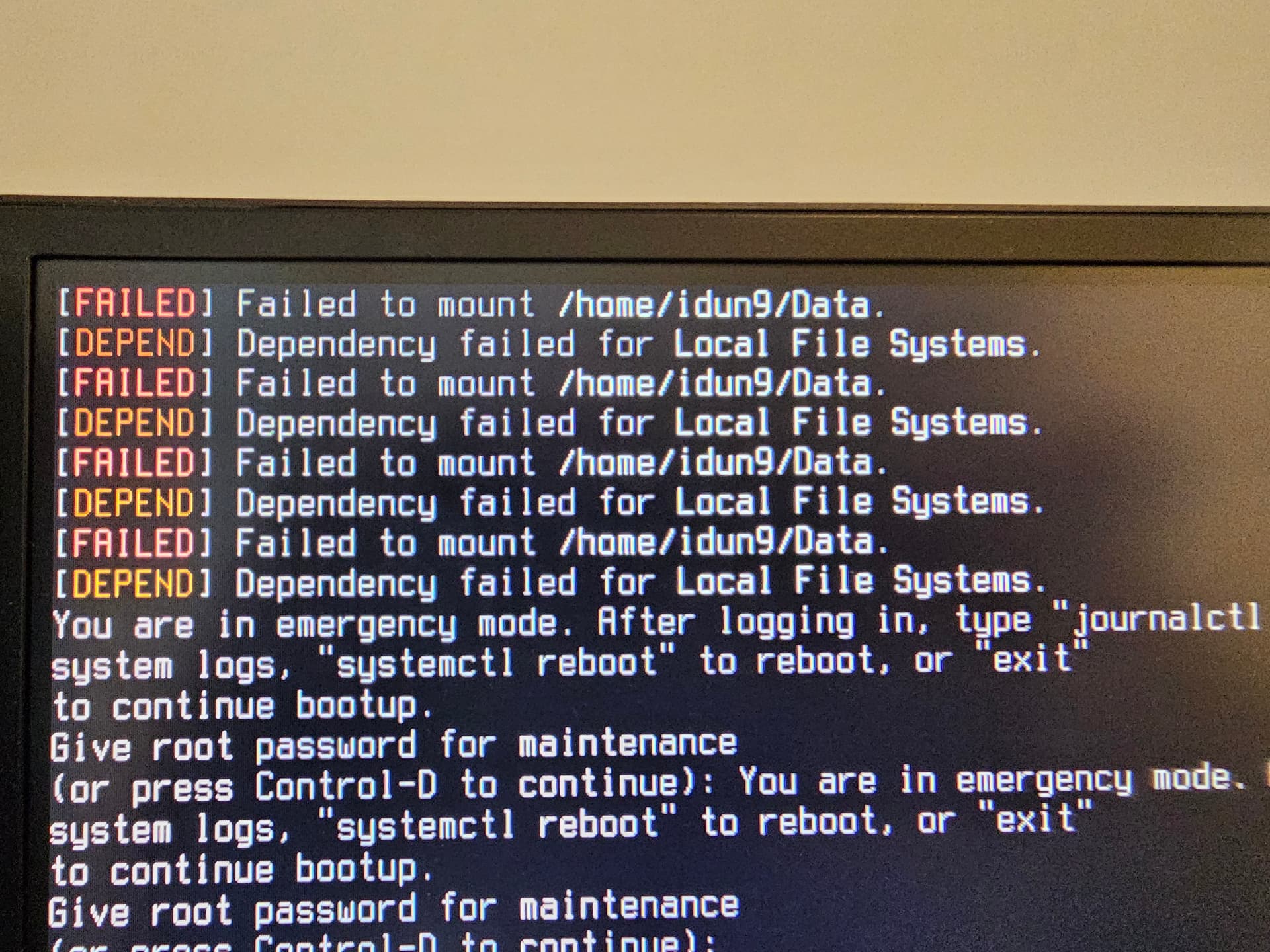

Failed to mount external drive during boot
When i boot my machine i quite often get the error “Failed to mount /home/idun9/Data” “Dependency failed for local file systems”

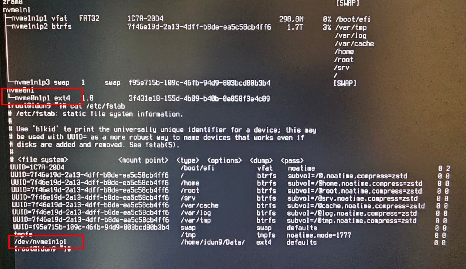

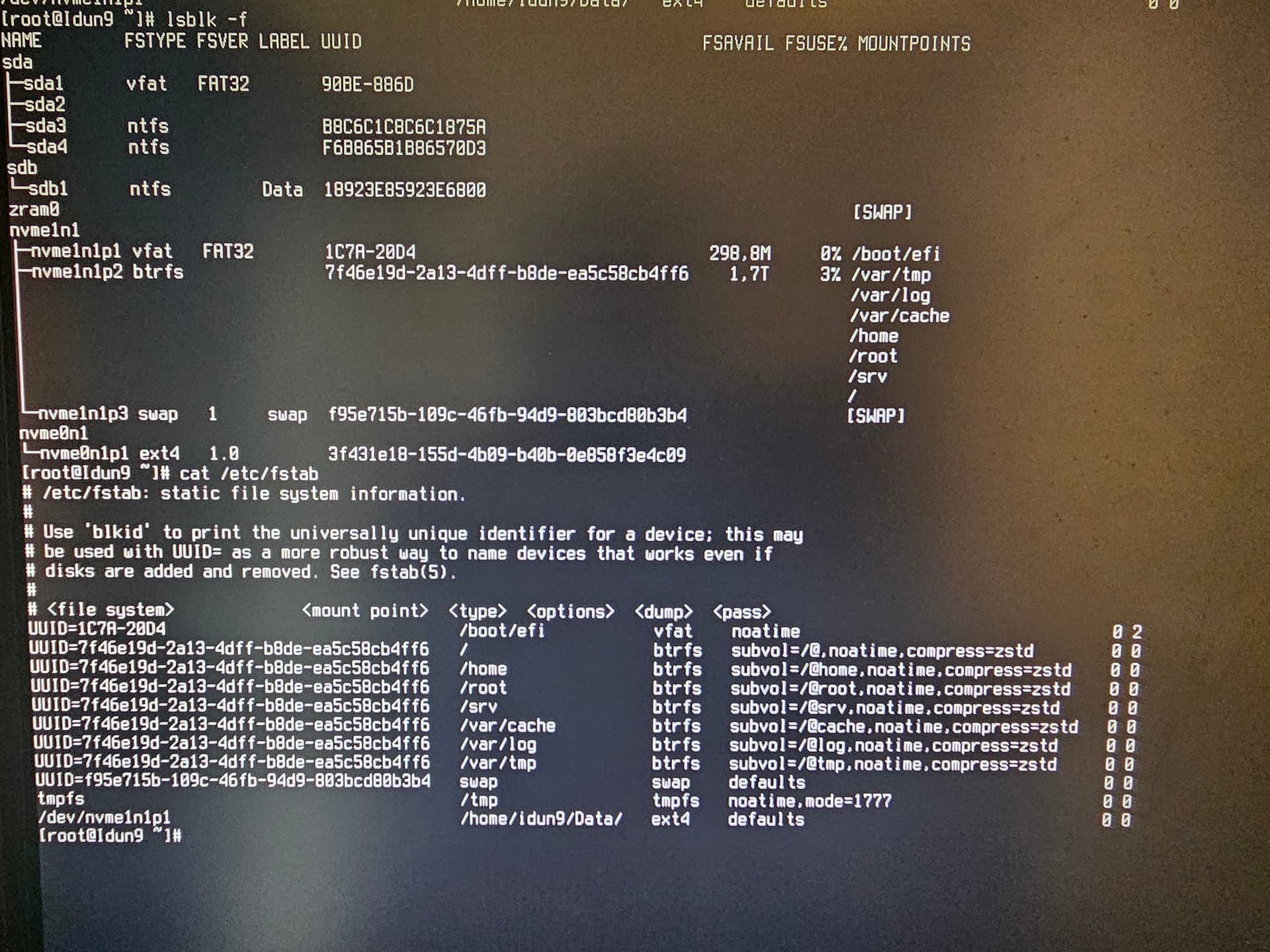

This usually happens if i select to boot Garuda before the 5 second pause during boot menu autoselects. If i leave it to autoselect it goes fine
When I get the error I’ve been double checking my fstab and verified my drives and they all match up. After his has happened i usually just reboot again either using “sudo systemctl reboot” or press the reboot button on my PC it usually boots fine but sometimes it needs a few tries.
Since fstab and device name is correct each time and the drive that its failing to mount is another SSD which i use for my main data folder I believe this is just that the drive is further away from my CPU and hence not always initated when system is booting and simply just need a bit more time. Would it be enough to just add " nofail" to my fstab as this is just the data file and hence have no need to be loaded during boot as long as it’s up by the time KDE has loaded? Or is there something else that can be done for this issue?

I’ve checked journal previously but not giving much except that it can’t find the drive. The 2nd picture I could just use normal terminal and copy paste the info but the first image is only shown during the boot so not sure if I can provide message how it appears without it being a picture.
I’ll show journal next time it happens but that will also be a picture

I just noticed the drive is mounted as /dev/nvme1n1p1 in fstab. Try changing this to a UUID instead. You can find the UUID with a command like blkid or lsblk.
lsblk -o NAME,UUID,MOUNTPOINT

If we can get back on topic now, I took another look at the photo in the post and realized the photo has perfectly captured the issue at hand:
This is why you should not use kernel name descriptors for block devices in /etc/fstab. They are not persistent, and as you can see they are subject to change at boot (in this case the drive is sometimes /dev/nvme0n1p1, and sometimes /dev/nvme1n1p1).
This should solve the issue:

changed it to use GUID instead of device name. I’m 100% sure I’ve verified the device name to be correct at other times before when this has happened. Done some more tries today with GUID and so far it’s booted without any issues.
